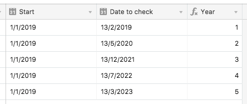

Is this ok?
My formula:
DATETIME_DIFF({Date}, Start, 'years') + 1
