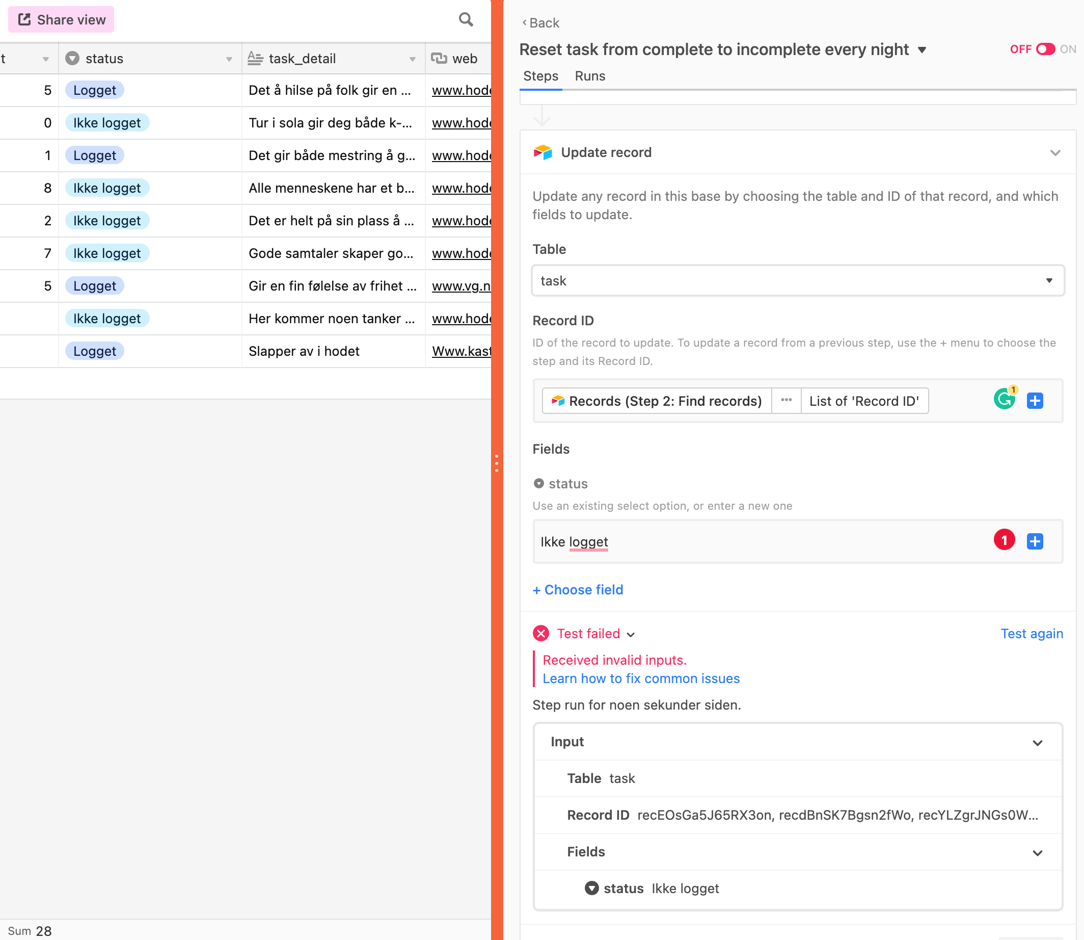

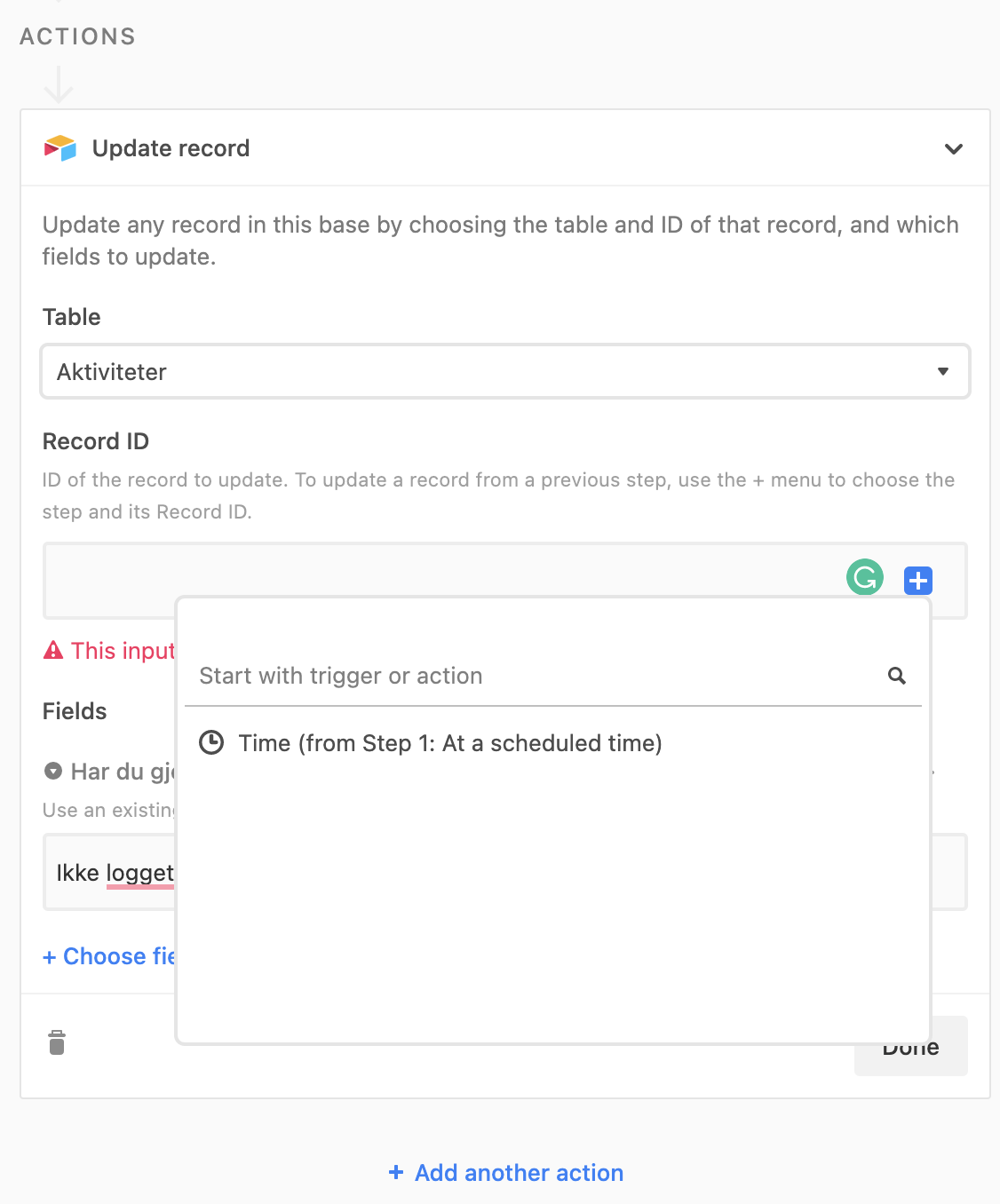

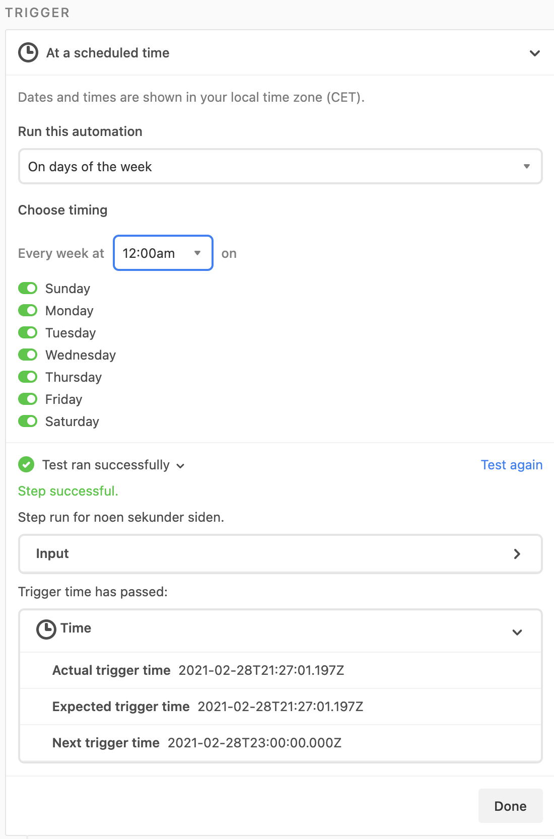

Q1: How can I make sure that any tasks that are marked complete (logget in Norwegian), are reset to incomplete every night (Ikke logget in Norwegian). I have tried to schedule automation, but I can’t find out how to describe the record ID, when using “changing a record” as action. I would like to change ALL the records that has been completed back to incomplete.

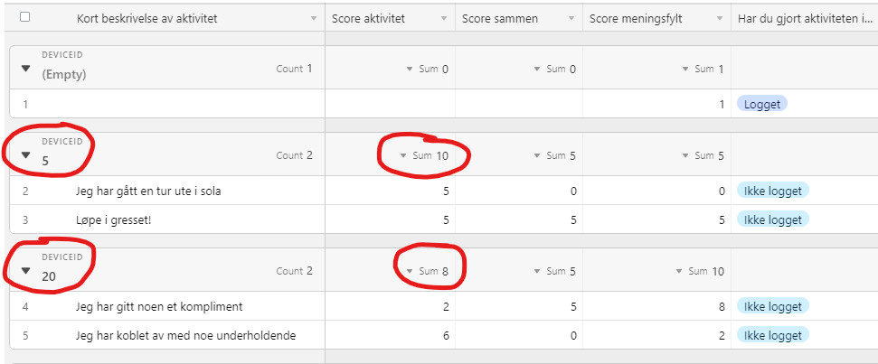

Q2: How can I summarize the values in a specific field (Score aktivitet) based on the field “Device.ID” In other words, how can I calculate how many points the user (Device.ID) has in “Score akivitet”, “Score sammen” and “Score meningsfylt”?

When using “update record” as an action, use the “+” under “record ID”, choose “from step 1” (don’t forget to “run test” your trigger step) and just insert “record ID”.
Have you tried “grouping” on “Device.ID”? Then the summary will not only show at the bottom (which you already have), but also per group.

I am trying to do this with a “At a schedule time” trigger. So it starts an action every night.
But when using the use the “+” under “record ID”, I cant seem to have the ability to choose “Record ID”

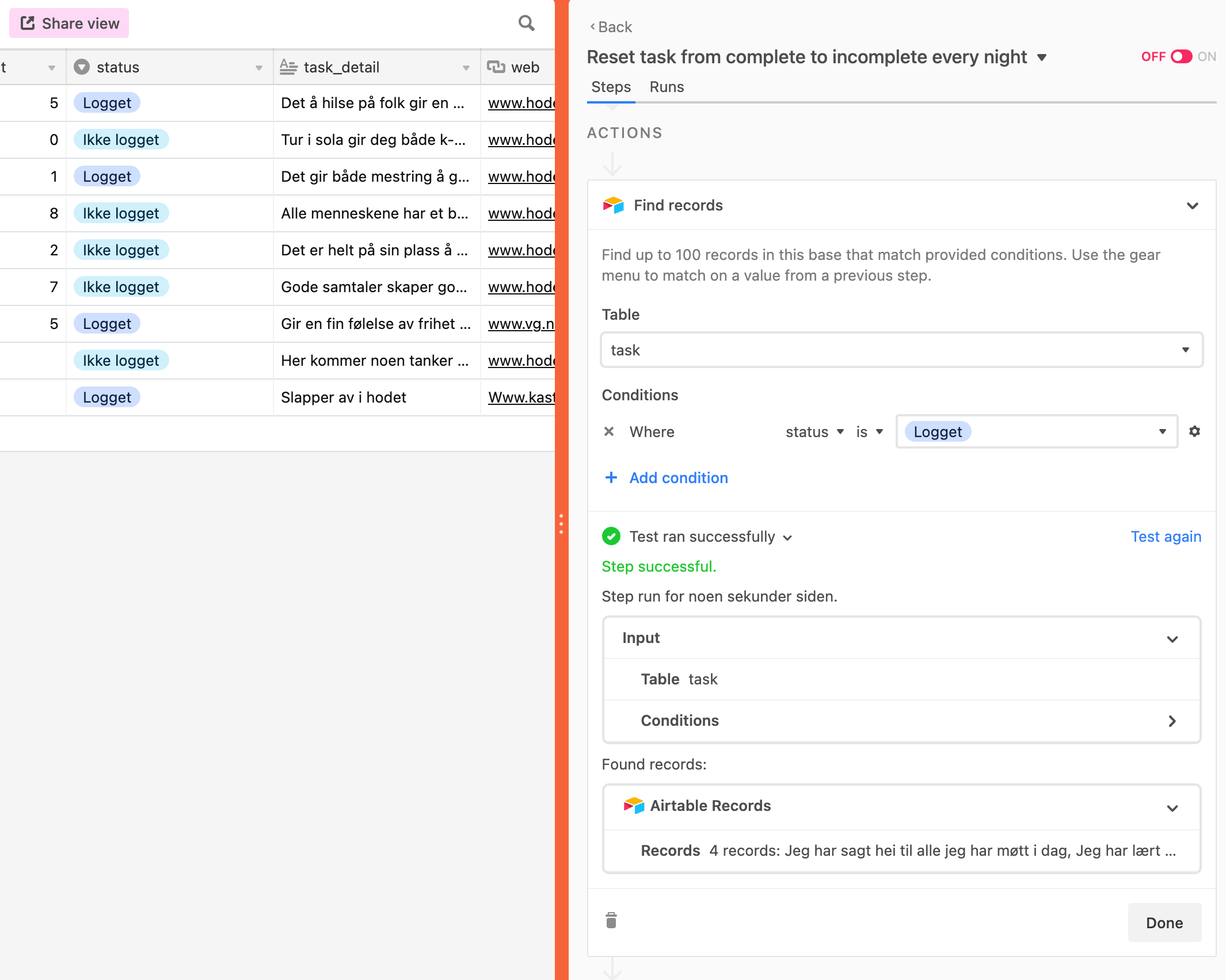

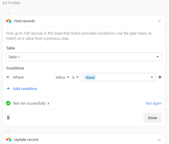

Ah, then you will have to add an “find records” action in between where you filter which records the automation should find (eg: where “task” is “complete”). Then you can use the “update record” action, where you use the ID’s from the records found in step 2.

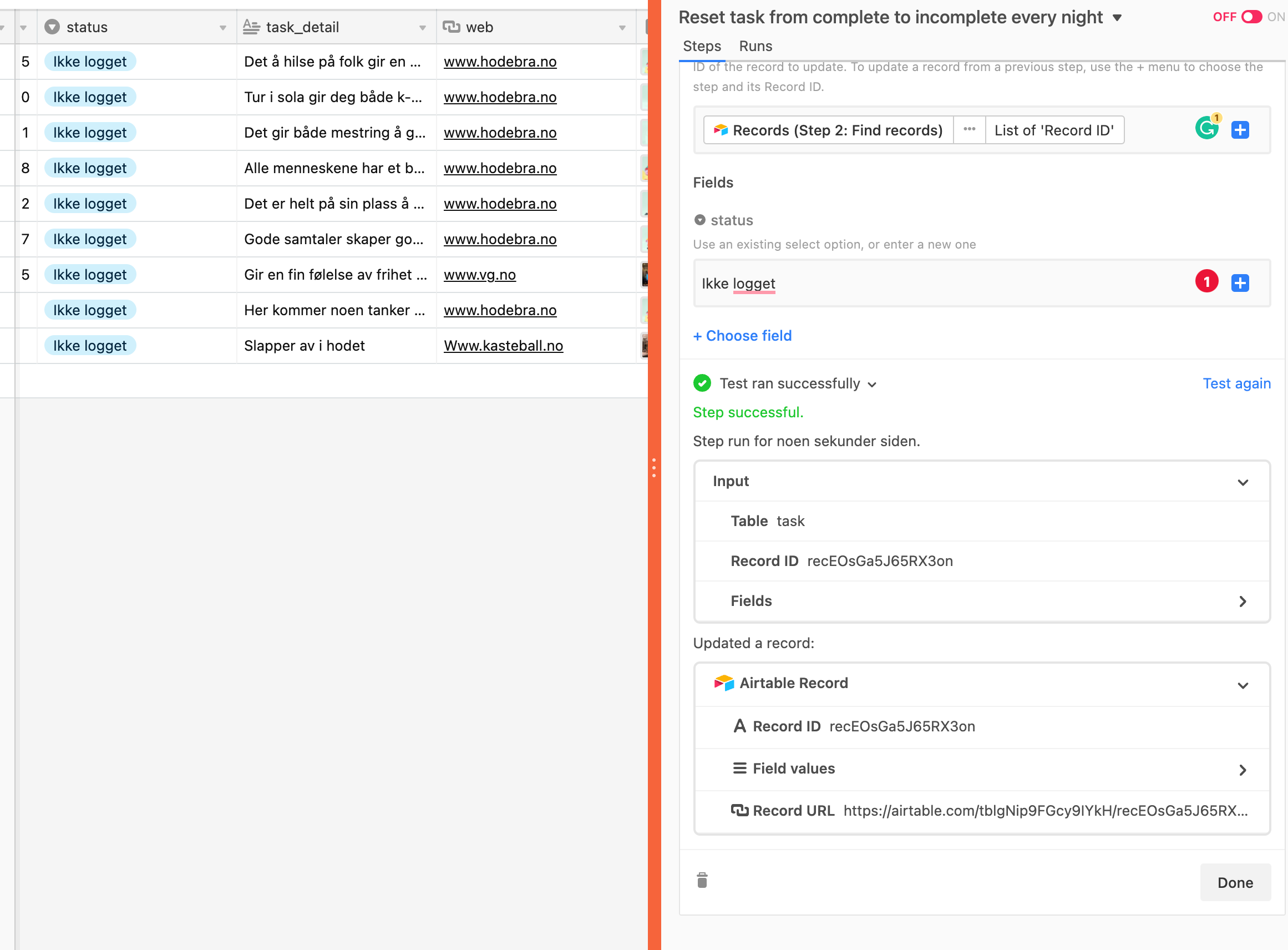

Close, but no cigar yet :slightly_smiling_face: Guess I am missing a step.
The “Find records” works great. It is able to find all the records that are complete (Logget):
If I have 4 records that should be reset from “complete” to “incomplete”, I get this problem:
But the “update record” only worked when there was just one “complete” record to reset.
Do you know why this is happening? I appreciate your guidance :winking_face:

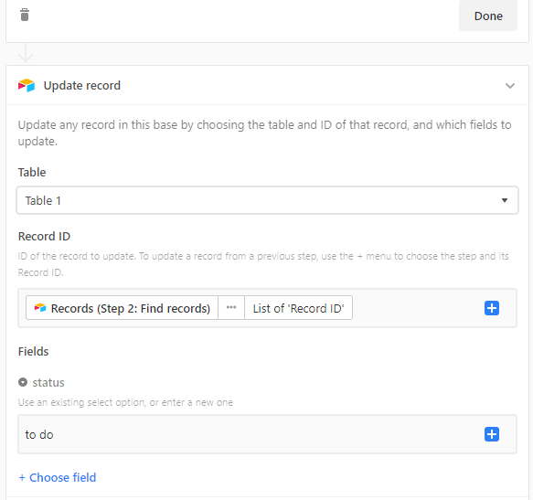

Hmm, I’m getting the same mistake. @ScottWorld , what are we doing wrong here? :slightly_smiling_face:
  • Mar 2, 2021 2:15 PM UTC
Unfortunately, the “Find Records” action in Airtable’s Automations doesn’t function how most of us would have expected it to function. :cold_sweat:
The “Find Records” action only returns an array of Record ID’s, but Airtable won’t loop through those record ID’s to take individual actions on those individual records.
The only thing it does is give us a list of Record ID’s which we can then paste (as a group of ID’s) into a linked record field or pass into a JavaScript for looping there. That’s about it. (We can’t separate out the individual ID’s nor loop through the individual ID’s.)
Off the top of my head, I can’t really think of what else we could do with those Record ID’s, although I’m sure there’s something that I’m not thinking of.
In my personal opinion, it’s a real shame that Airtable implemented it in this way, and it should be improved. I would highly recommend emailing support@airtable.com to request that they improve this.
So if you want to update the value of individual records, you can’t use the “Find Records” action to find those records. I know, it makes no sense at all. :man_shrugging:
(Some might say it’s essentially useless, although I could see some use cases for pasting a list of Record ID’s into a linked record field).
So, unfortunately, these would be your only options:
  • Use “Find Records” and then trigger your own custom JavaScript to loop through those Record ID’s and take individual actions on those records.
  • Create an automation that doesn’t incorporate “find records”. This would trigger on one record at a time.
  • In my personal opinion, the best and easiest low-code/no-code way of handling automations is to use the professional automation platform Integromat. Integromat has NONE of the limitations of Airtable’s automations, and many people can get away with their free pricing plan, so it won’t even cost you any extra money. (Note that I am a professional Airtable consultant and a Registered Integromat Partner, and the Integromat link contains my personal referral code.)
