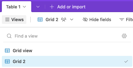

Hm, I just tested this and it takes the first view in the list, not the first view that was created
And so in the following scenario, any changes we made to the "Grid view" view fields would be utilized when accessing linked records from this table
And if we wanted the field setup from "Grid 2" to be used in our linked records, then we'd just need to drag Grid 2 to be the first view in the list like so:
I'm wondering whether the issue you're facing is to do with someone having a personal view that you can't see being the first view?  Not sure though
Hey ​@Support_IT you’ll want to follow instructions quoted above. Is this still not working for you??
