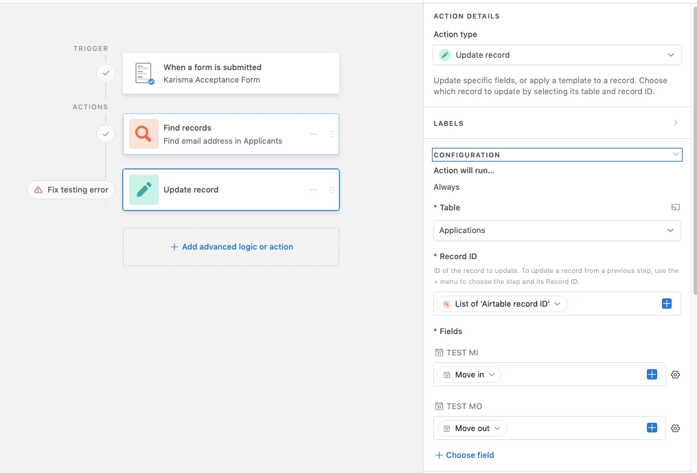

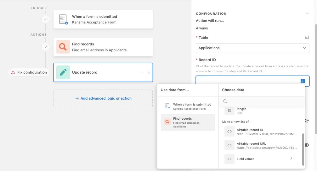

Somehow it's still not working...
Acceptance form is in tab #2 and asks about the move-in and move-out dates, which I want to add to the Applicants table in tab #1.
See any mistake...?

The "Find Record" step's returning more than one result for that email address which would cause the "Update Record" step to fail as it expects a single record ID
This means that there's more than one record in "Applicants" with that email address.  Is this expected?
Your "Update Record" step currently updates the move in and move out dates which works fine.  Alternatively you could make it link the two records together and use a lookup field too
