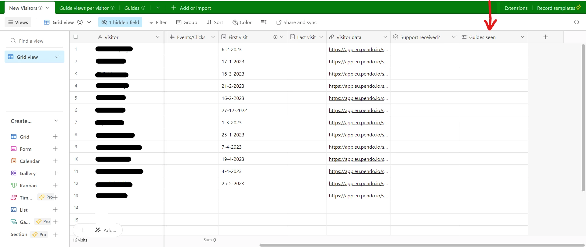

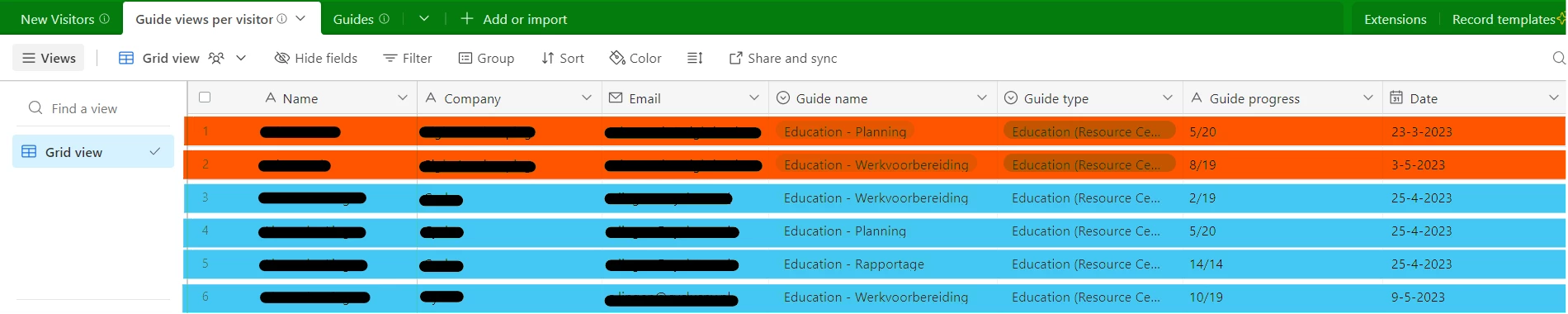

Hey there! As I am new to using Airtable, I am wondering how I can link multiple records with the same value to a record in a different table. Let me be more specific below.
I have two tables:
1. New Users (A list of unique new user that started using an application)
2. Guide views per visitor (A table with records that record every single in-app guide view, progress, date, etc.)
In the Guide views per visitor table it is possible for there to be multiple records of the same user, for instance when person A has seen guide X (record 1) and guide Y (record 2). Ultimately, I would like to showcase which guides every new users has seen in a column in the New Users table. Would love to hear how and if I will be able to do this through linking records or automation?
