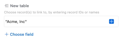

  • Apr 1, 2025 6:25 PM UTC
Bumping this again as I’m running into the same problem and I don’t believe it has anything to do with the automation.
I have a list of customer survey responses. Some clients provided multiple responses, therefore we have several records with the same data in the ‘Client’ field.
I am trying to link to another table so I can show a de-duplicated list of the Client names with their corresponding responses, but the linking is going wonky on me because some client names have commas in them (ex. “Acme, Inc.”). When linking, Airtable picks up the data from this column as TWO DIFFERENT client names, “Acme” and “Inc”. Pretty painful for what seems like a small problem.
Perhaps there’s a simple way to edit the ‘Clients’ column to tell Airtable not to split the record even when there are commas?
Arthur
  • Apr 2, 2025 3:18 PM UTC
^ After some fiddling, toggling off “link to multiple records” seems to have worked for me now although I’m not entirely sure what I changed to make that work.
  • Aug 13, 2025 3:25 PM UTC
I tried this and it was still creating the two linked records, were you ever able to find another solution. I have the exact same problem with the Acme, Inc example.
Hm, could you try wrapping your text inside quotes and see whether that helps?  Works in Airtable automations at least, so it might work in your automation tool
I just wanted to confirm for others that discover this that this solution works - put double quotation marks around your Zapier variable: “[variable]” and it should prevent Airtable from duplicating records.
