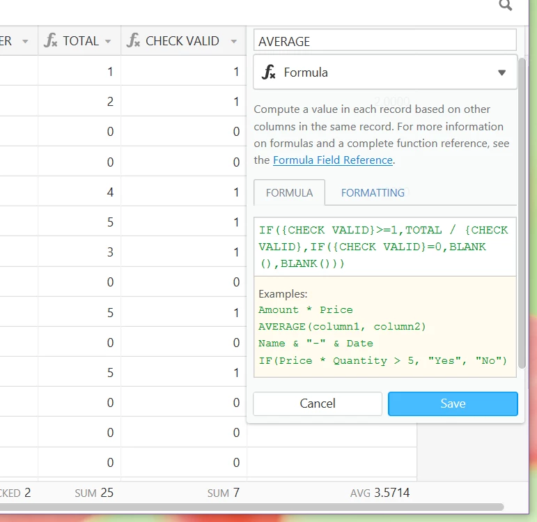

Hi Lucus, did you solve your problem? I found a way to get the correct average without using a rollup. Kind of old school. In my Table I wanted votes counted and averaged based on a scale of 1-5. But voters also had an option to “Not Vote” or indicate that their votes was something “Other” or didn’t fall into the scale of 1-5. If their were a “no vote” or “other” the votes was counted as “0” or null. So when I tried to get the average the “0” was calculating in my Summary and then it would return an incorrect average - because the zero’s would lower the overall average. Here a couple of screen shots. (this is my first response/post - so I hope you can see the images).
So to work around this I used a formula instead. In layman’s terms it was like this:
IF the vote is valid - then divide the total number of votes / by the number of valid votes, and IF the vote was invalid (or 0) return a blank.
So then when I set my summary to give the average of the field it did it correctly:
Total votes (25) / total of valid votes (7) = 3.5714.
Hope you or maybe someone else finds this helpful.
~Elaine

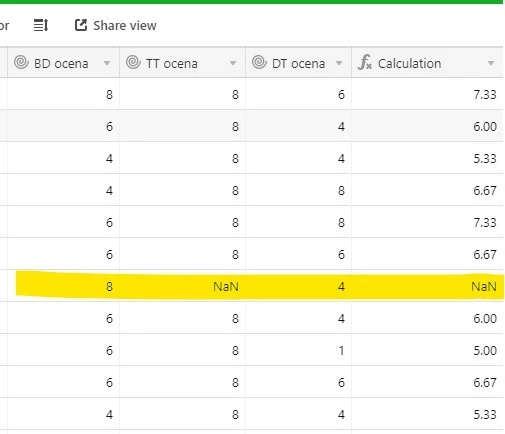

I am trying to get correct average with rollup. Is there a way to ignore the fields that don’t return any value (NaN) in the example?
  • Nov 15, 2024 2:11 PM UTC
Use IF(ISERROR) functions in formula
