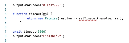

@Bill.French Has anything come from this desire - I’d like to know if Airtable plans to open up the ability of Devs to create 1st class Blocks on their platform.
So far my experience with coding has been to run into problem after problem. My lack of JS knowledge is part of the big picture. But hey - that’s why I want 1st class citizens of Blocks. My current stumble is the setTimeout() method is not found in the Airtable scripting block. So I cannot create a pause method to time my 3rd party API calls to their restrictions (5 calls / min.)
  • March 17, 2020
Good news - it’s been opened to requesting developers now.
In non-blocking architectures, there is no such thing as timeout’s per se, but this is the answer. That code works fine.

Thanks for the help.
This is getting deeper and deeper…
I tried your code in my Script - it fails with an error
ERROR
ReferenceError: Can’t find variable: window
So it’s not working for me. Then I tried in a brand new script with no outer code and it runs & works.
So… hmmm …
  • March 17, 2020
ERROR
So… hmmm …
Opps! I found my call to print out window I put in lastnight. OK
Today it’s running… now…
I had same/similar code failing last night…
Thanks for your help! I’m stumped as to why - but it’s working now!
