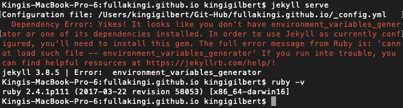

Hi! :slightly_smiling_face: Thanks for this awesome plugin :thumbs_up: . I am way more of a front-end designer turned hacker and so was carefully following your instructions.
I was wondering if you could give any tips on this error as I can’t run jekyll serve:
I’ve run bundle install and bundle update - seems ok?
It seems the dotenv is installed
My gemfile seems to be setup correctly
I have the _plugins folder and the environment_variables_generator.rb setup
.gitignore file has the .env thing added
i am wondering if it is to do with the folder /_plugins not being compatible with GitHub?
(sorry I can only upload one image per post right now and I can’t include links in my posts)

Hi, sorry for the belated response. If you can, please provide me with the link to your repo, I’d happily take a look at it
Hi, I have the same problem. Did you have any success installing it? I installed the gem as described but get the same error-message with “jekyll serve”:
