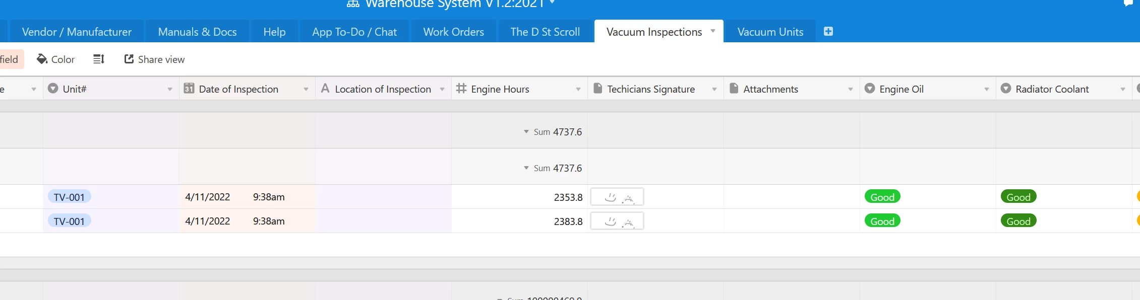

I have integrated my Jotform with my base for inspection sheets on heavy equipment and have it assigned to fill a table called Inspections. everything in this section works perfect and i collect all the data from the forms.
What I am trying to do.
One of the columns I am trying to track is the Engine hours column which is located in the Inspection table. each piece of equipment in the inspection table can have multiple inspections a day. I am trying to track it in another table called Equipment Log which each piece of equipment is automated to link to its inspection record. I have tried using Rollup to Sum the total Engine Hours the unit has been inspected to have. the problem I am facing is the inspector only has to put the hours that are displayed on the machine Example: 2353.8. the problem i am facing is if another inspection comes in and the hours read 2453.0 I end up with ( 2,353.8 + 2,453.0 = 4,806.8) where I really only need to know the Difference between from the first inspection record and every inspection after that. So I can track due dates for oil changes and regular maintenance.
