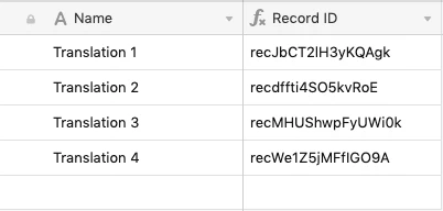

Exposing Airtable’s internal record ID is simple - a formula field will do that.
You want to expose that ID in a linked table, right? Wouldn’t a rollup do that?
