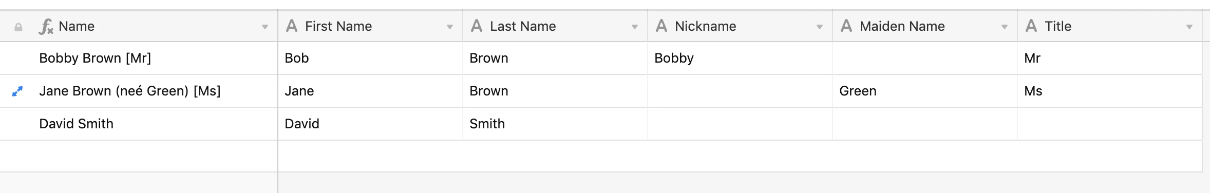

Hi!
I have a problem really similar to this and though I can see that this has the solution I still manage to tangle myself somewhere in the formula. I weight the pros and cons of writing here vs. starting a new topic and I hope I made the right decision.
I want my primary field to display info from five fields; {Nickname}, {First Name}, {Last Name}, {Maiden Name} and {Title}
The fields {Nickname}, {Maiden Name} and {Title} are conditional and I only want them to display if not blank. No empty spaces in the output.
I would like outputs like below;
Nickname Last Name
Nickname Last Name (neé Maiden Name)
Nickname Last Name (neé Maiden Name) [Title]
First Name Last Name
First Name Last Name (neé Maiden Name)
First Name Last Name (neé Maiden Name) [Title]
I’ve managed to get {Nickname}, {First Name}, {Last Name} and {Title} to work, though likely not in a very elegant way, but get tangled on the {Maiden Name} part. As I’m relatively new to Airtable and this is my first post I would be beyond greatful for help with this.
JonathanBowen
Hi @momentsgoneby80 - something like this?
IF(Nickname, Nickname, {First Name}) & ' ' & {Last Name} & IF({Maiden Name}, ' (neé ' & {Maiden Name} & ')', '') & IF(Title, ' [' & Title & ']', '')
JB

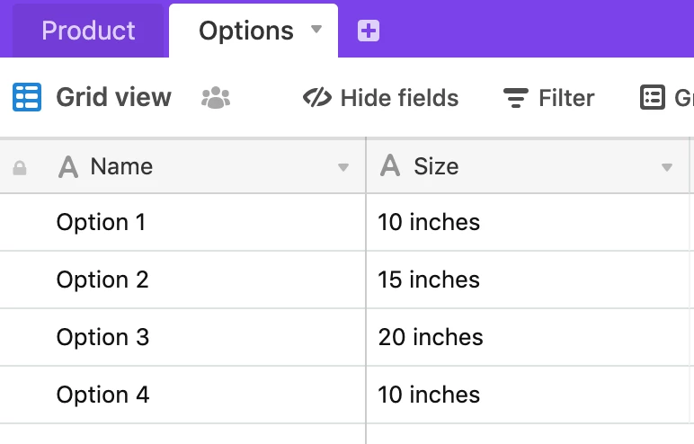

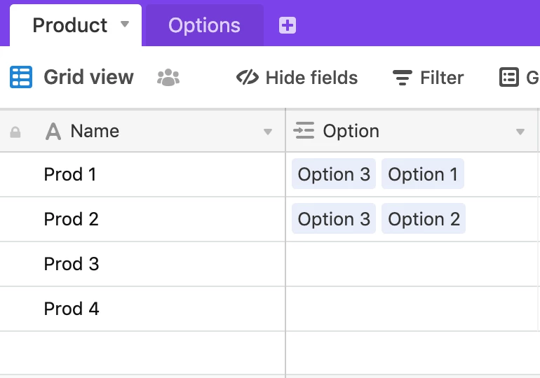

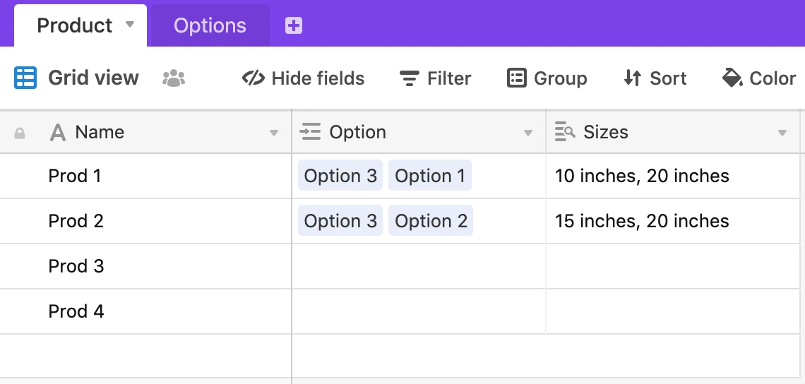

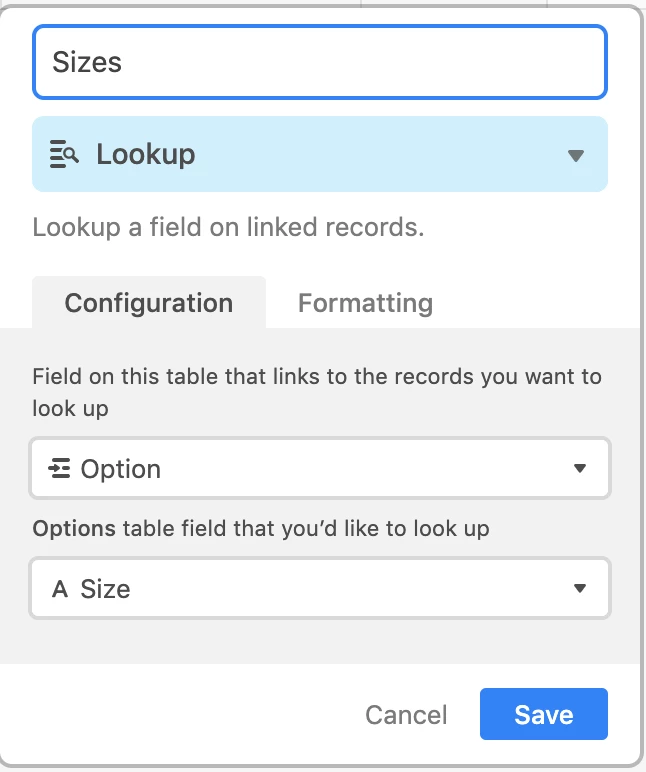

I know that an IF formula can only delivery a true/false answer, but I was wondering if there is another formula that delivers multiple values if you select multiple answers in a multi-select fields.
I have a {Product Size} multi-select category thats gives you the option to select Option 1, Option 2, Option 3, and/or Option 4. I would like the a {Imprint Size} category that will show the variety of imprints needed.
Option 1 = 10 inches
Option 2 = 15 inches
Option 3 = 20 inches
Option 4 = 10 inches
As you can see some options equal the same amount.
Example: If Option 2 and Option 3 are selected I want my Imprint Size formula category to read “15 inches, 20 inches.”
I have been trying to figure this out for a few hours now and have tried a few different formulas but I can’t figure out how to deliver different answers.
Thanks!
