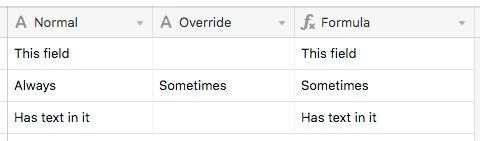

Welcome to the community, @Ralph_Mittman! :grinning_face_with_big_eyes: You didn’t include your existing formula, so the best I can do is work from scratch based on your description.
The formula field is pretty simple:
IF(Override, Override, Normal)
To translate: if the {Override} field contains anything, use it. Otherwise grab the contents of the {Normal} field.

In cases like this, using an operator can actually be too precise of a comparison. When all you want to do is see if the field has anything in it, the field reference alone is a simpler shortcut because it just pulls the data. Any data will evaluate as TRUE; no data will evaluate as FALSE.
