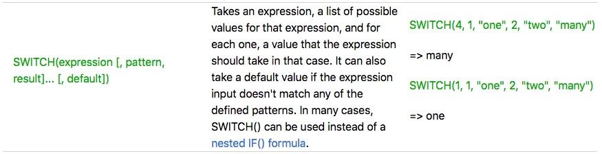

I think this is case where you could use the SWITCH() function:
SWITCH(
   {Contractor},
   "Peter", 0.25,
   "Bob", 0.15,
   "ABC Contracting", 0.3,
   etc..
