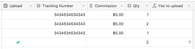

What is wrong here?
IF(AND({Tracking Number}=BLANK(),Qty!="",Commission=BLANK()),OR(AND(Upload=1,Commission=BLANK())),1)
I am still getting everywhere a 1
Please look on this screenshot
I’m guessing you want a 1 in the field if either of the AND collections come back as true, which is why you added the OR. However, the OR is in the wrong place. It needs to surround both of the AND functions:
    OR(
        AND(
            Qty!="",
            Commission=BLANK()
        AND(
            Upload=1,
            Commission=BLANK()
    1
Does that give you the result you want?
  • June 7, 2019
Something is not good: Sorry, there was a problem saving this field. Invalid formula. Please check your formula text.
Not sure what the problem is. It works fine here:
Make sure you copied the full formula. Perhaps the closing parenthesis got chopped off during copying?
  • June 7, 2019
Thank you Very much, it did work as you told me
