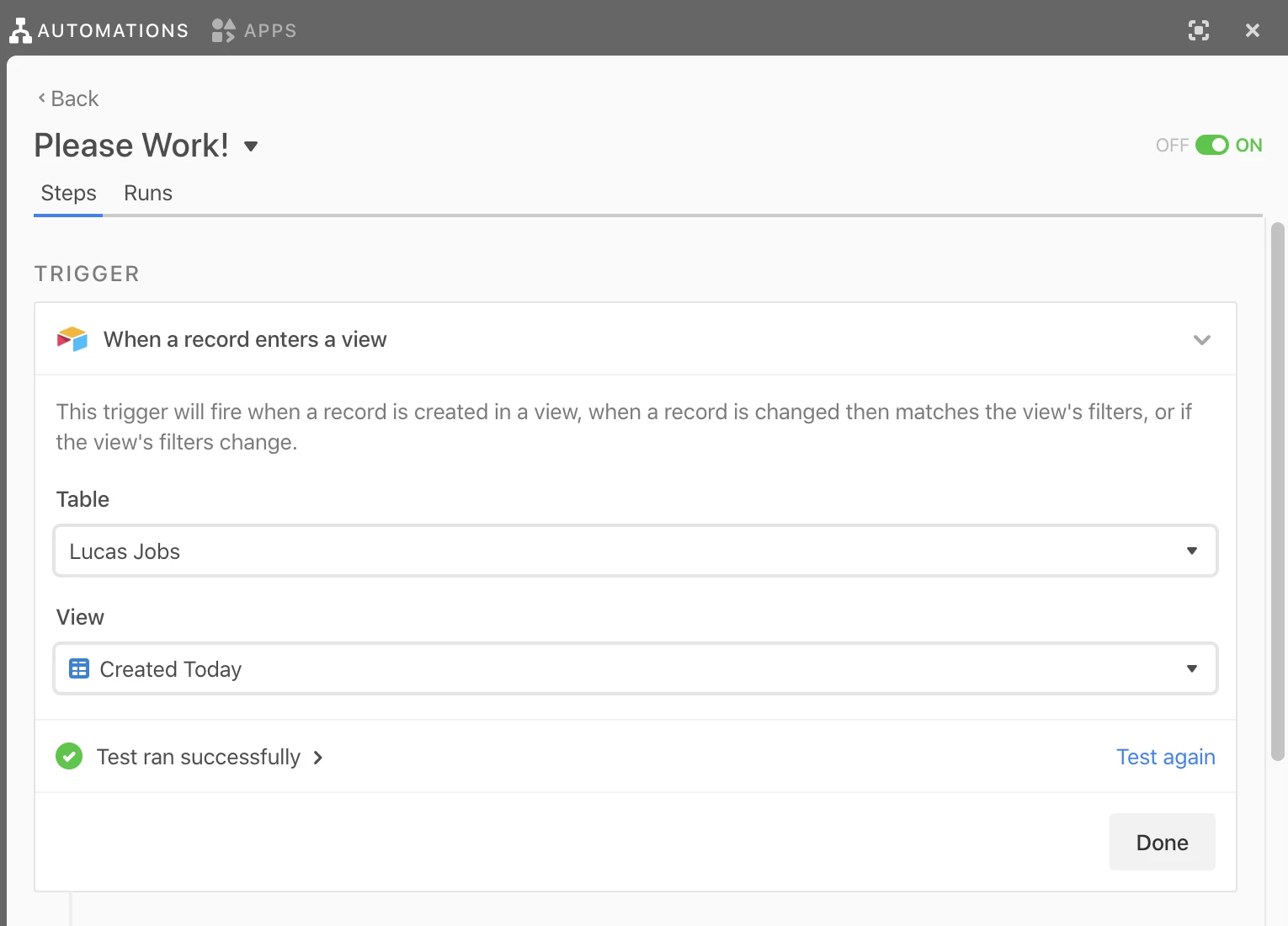

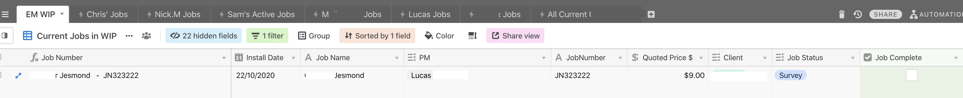

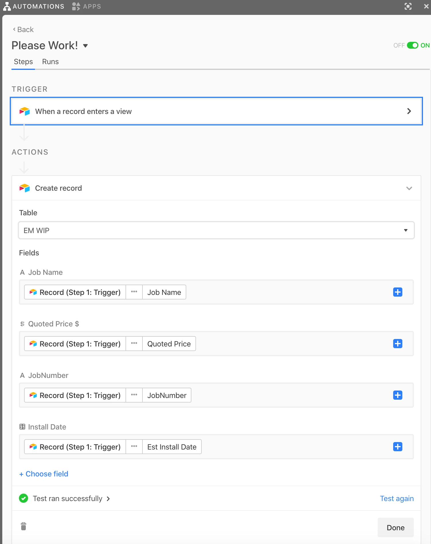

Hi All,
Thanks @Kyle_McKinnon
I am trying to do something similar. I must be missing something the obvious.
I am trying to get new records from my Synced Tables (Chris, Sam, Nick, Lucas, Etc) into the main table EM WIP. Which appears to be working in creating, however I would like it to also update in the EM WIP when any of those users update their own bases which im synced with…
