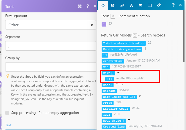

Just seeing if anyone knows why this field is coming in with all these wierd letters instead of the car models? Suppose to be Chevy, Ford, etc… and getting these weird letters.
I need to use this filed further down in my integromat scenario. Thanks,
That’s the Record ID for the Linked Record in the Make field (see the ‘id’ field 3 lines before, it’s the ID for the Car Model record). You can use Lookup fields to bring Make’s data into Models table.

Ok thanks… I’ll try some stuff. Other option is to ad another module in Integromat and look up that ID I guess.

I think Integromat knows nothing about the Make record, and you have to add the fields to the Car Model table. But may I’m wrong :man_shrugging:

Oh you meant to use Retrieve a Record module, using that ID.
