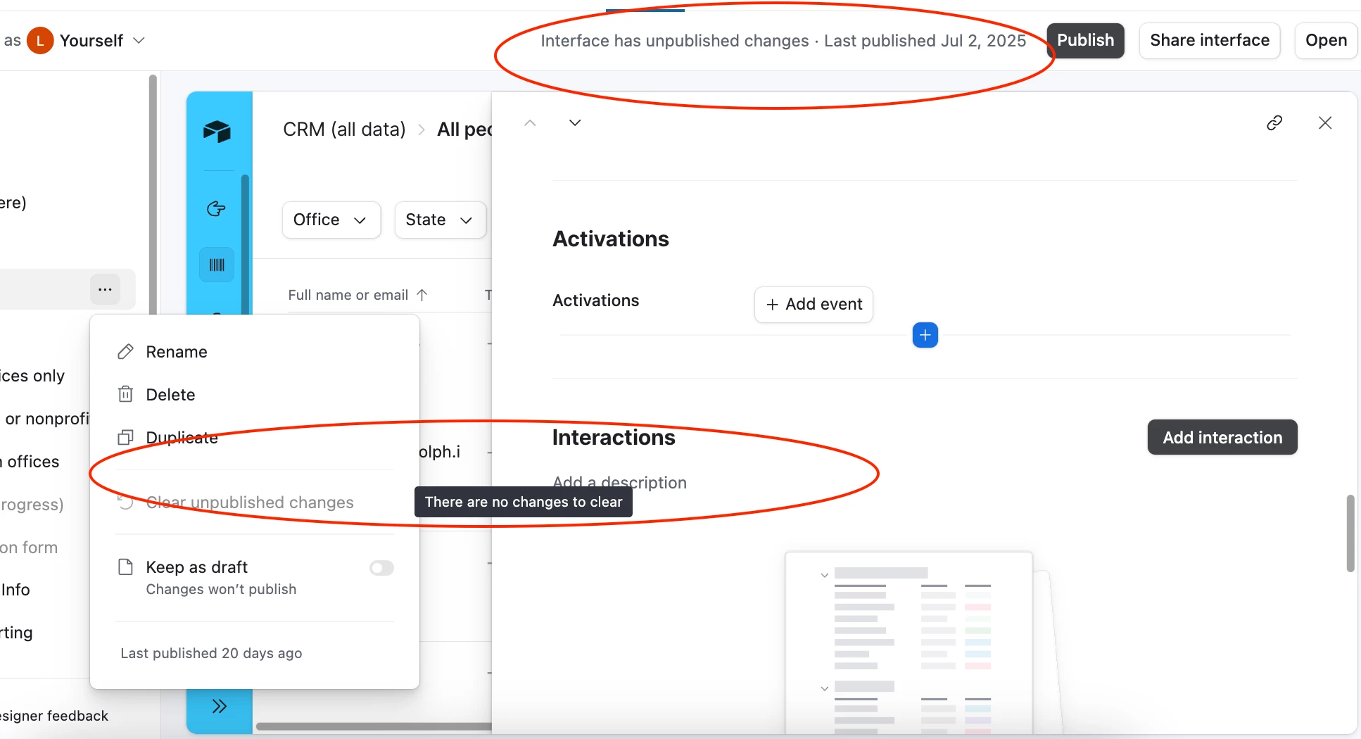

I ran into this today.
To be clear, I think there are a two options:
  • clicking the “keep as draft” field will keep the changes from publishing.
  • Clear unpublished changes will (allegedly) clear the changes you’ve made but not published.
However, it doesn’t seem to be working as I would expect. You can see here that my interface has unpublished changes, but the option to clear unpublihsed changes is greyed out, and says “there are no changes to clear.” Because of this, I’m not clear how to “revert.”
Hey ​@laurenCTCL,
Do remember that the Publish button on the top right allows you to publish changes made on different interfaces and pages simultaneously. Having said that, I would guess that you do not have any unpublished changes for the specific page that you clicked on the 3 dots for, but that you do have unpublished changes for other pages.
Sounds like that could be the case? Please keep me posted!

Thanks ​@Mike_AutomaticN - yup, the changes are on the page i showed. It’s fine to use the function of not publihsing the changes to a specific page, to revert changes.
