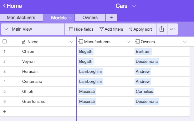

You can get information from the Owners table to the Manufacturers table using rollup fields. Here’s a table I’ve mocked up following your instructions:
This Models table has links to the Manufacturers and to the Owners.

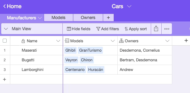

Now, let’s look at the Manufacturers table:

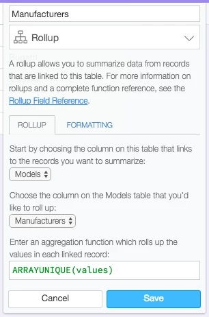

The rollup field on the right is set up to look at a particular linked field in your table and draw information from the other table to which the field has been linked. It’s set up like so:
This means that this field looks at the Models field here, then goes to look at the table to which it’s been linked (which in this case is also titled “Models”), then returns the value found in a specified field in the Models table (in this case, the “Owners” field). The ARRAYUNIQUE aggregation function is there to ensure that you don’t have repeats of owners’ names (e.g., in this example, Andrew owns two different Lamborghini models, but his name only shows up once).

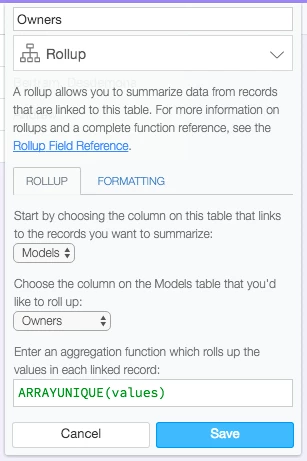

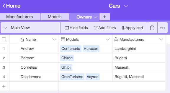

You can do something similar in the Owners table as well:
