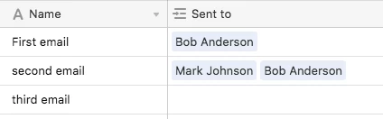

Here’s a test setup I made. In my [Emails] table you can see the emails that have been sent, and the recipients for each one. I’m guessing you’re adding new users over time, so I tried to mimic that in this setup:

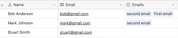

And here’s the [Users] table:
I want to add “third email” to all three (or all 40 in your case), which is tricky because if I copy from one and paste it into the others, they’ll all have identical links, instead of just adding the new one.

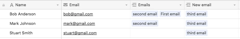

To work around this, I’m going to start by adding a new field to [Users] that links back to [Emails], and link only the new, third email in there. This can be done by adding it in one, then drag-filling the rest:

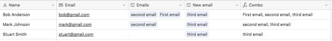

I’ll add another new field that uses a formula to combine the collection from {Emails} with the single from {New email}, separating them all by commas. Here’s the formula:
IF(Emails, ARRAYJOIN(Emails, ", ") & ", ") & {New email}
And how it looks in the table:

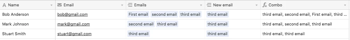

I can now take the full contents of that field, copy it, then paste it into {Emails}. Airtable will convert the text back into links to the [Emails] table, so we now have this:
Now you can clear out the {New email} field and reuse it for the next email.
