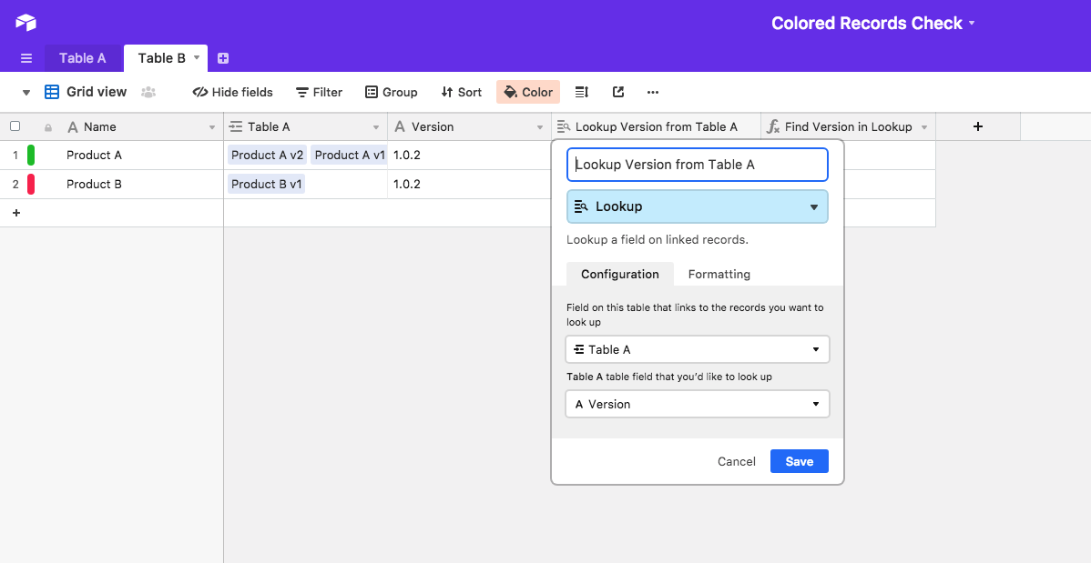

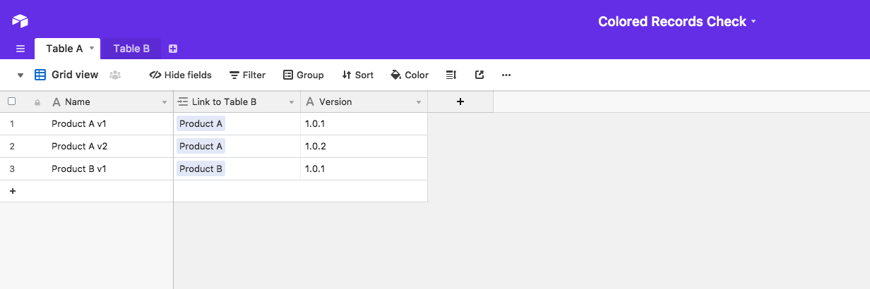

I assume Table A and Table B are linked in some way? If you have a field linking a record from Table A to a record from Table B, you can do this by pulling the field you need to check against from Table A into Table B with a Lookup field. Next, you’ll need a formula to check for the intended version from Table B to see if it exists in all the linked records from Table A. Then, you can base your color field on that final formula.

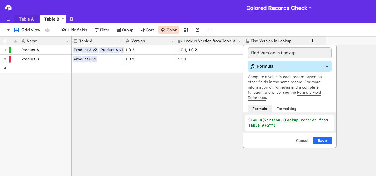

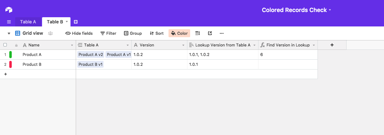

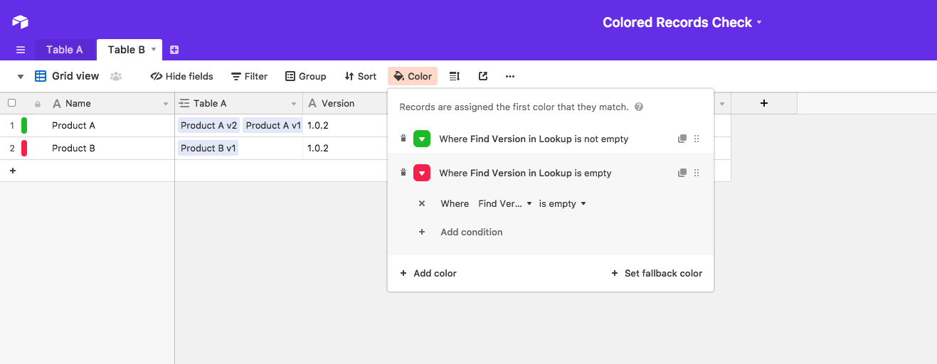

SEARCH() returns blank if the string is not found in the source, so the color check looks for “Empty” or “Not Empty” to determine if the versions match. You need that little &"" at the end of the SEARCH() formula to convert the value in the Lookup field from an array to a string.

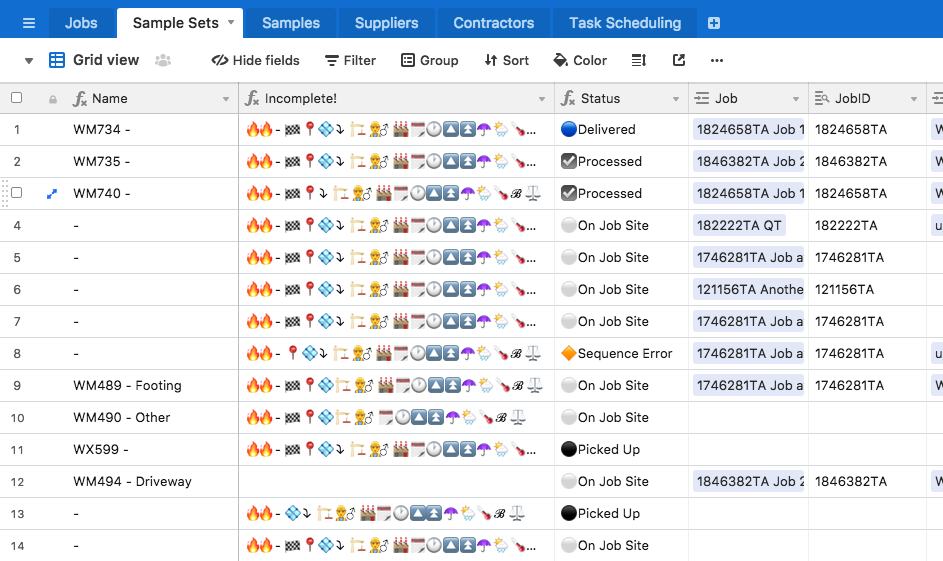

An option that comes to mind is to have a field called “Outdated Products” that lists each product version a person has that is out of date. It would require Lookups in the same way as above, and then combined with a big, long, hairy, nested conditional formula that makes checks against all existing products and spits out the info that you need into that one field.
Here’s an example of a similar style of field that I use:
Each emoji in that “Incomplete!” field is generated by a conditional check in the formula and represents a field that is flagged as needing attention - if none do, that field is blank. Not exactly like your use-case, but similar enough, I surmise.
If that sounds like an avenue you’d like to pursue and need more help, I’d suggest a new support post specific to any struggles you encounter trying to implement that.
