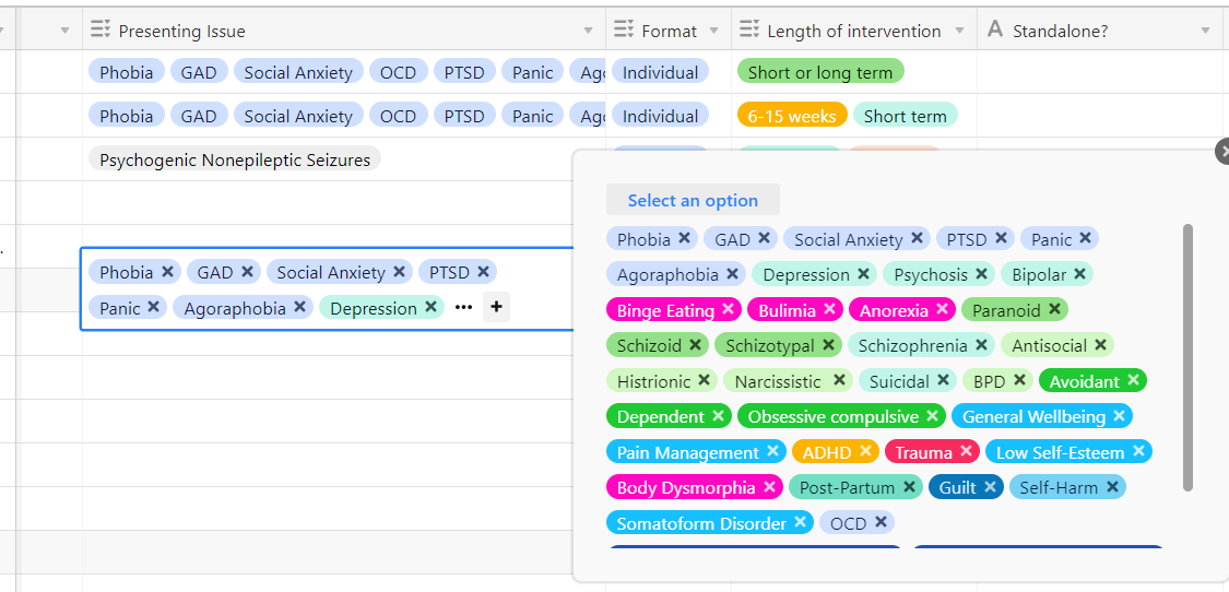

I’m putting together a base together with a list of therapeutic modalities on my y axis; and a multiple select field called ‘Presenting Issue’ on my x axis where I’m inputting the different presenting issues each therapy targets (e.g. CBT targets Phobias; Depression etc). I’ve a list of about 50 different therapies and would like to be have a view where I can look at the presenting issue and then see which therapy is ‘matched’ to the issue.
I assume the best way to do this would be with a Kanban view, however Kanban doesn’t seem to work with a multiple select field. Any suggestions of how I can a Kanban to work, or perhaps a different method to achieve a similar outcome?
Thanks in advance!

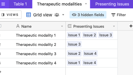

Hi Yehuda, hmm, may I know what issues you faced while using the filters to achieve this? Is it that you would like to have all of this data on hand, without needing to modify a view’s filters each time? Once I know that I might be able to suggest something that better suits your needs!

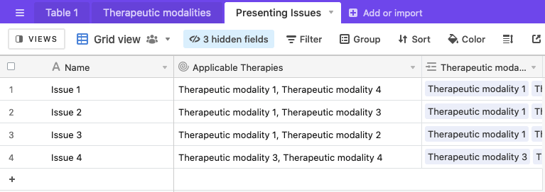

An alternative might be to create a “Presenting Issues” table and make each issue an individual record, which would allow you to do a rollup of the therapies, and you could simply go to the “Presenting Issues” table any time you wanted to view this information without having to fiddle with filters.
The tradeoff here would be that linking the issue to each modality becomes slightly less seamless, but if it’s a one off this might be worth doing.
Therapeutic Modality table:
Presenting Issues table:
Both of the above setups can be found here

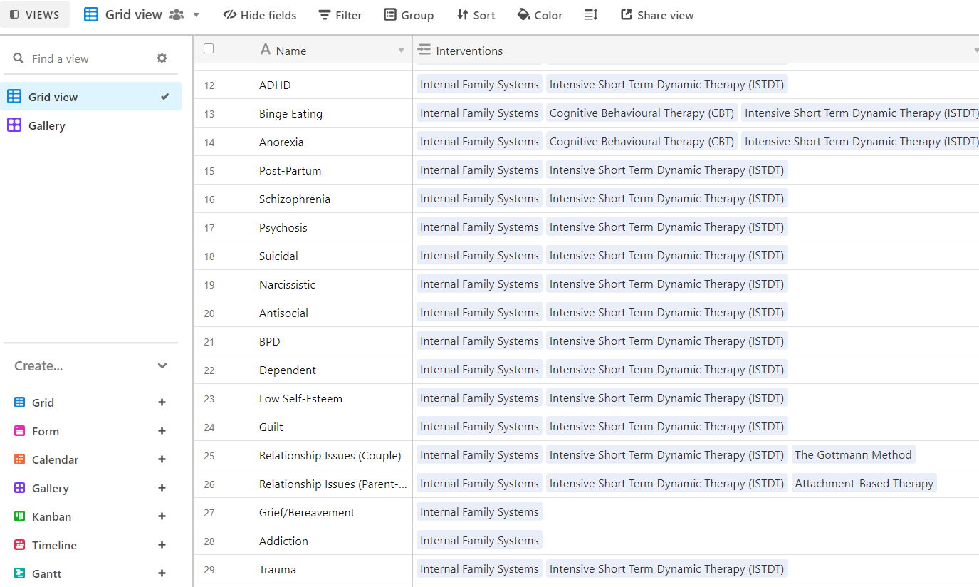

Once I’ve matched each issue (about 25 possibilities) with each therapy (about 50 therapies) then I’d only occasionally need to make adjustments. Does this sound like something very time intensive to set up?
Is this possible to do on the Basic plan?

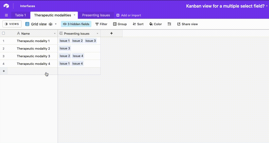

Super easy to set up. If you already know all the links, this will probably take you an hour max I reckon
Edited to add: And yes totally doable on a Basic plan, sorry for not answering that!

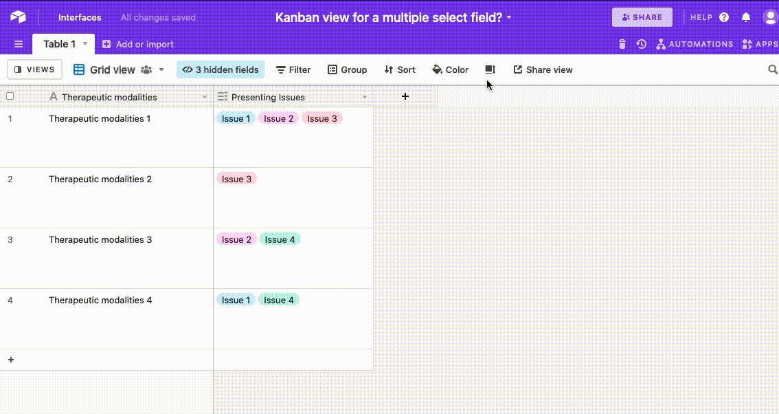

Here’s a gif of me linking a couple
  • May 17, 2022 4:26 PM UTC

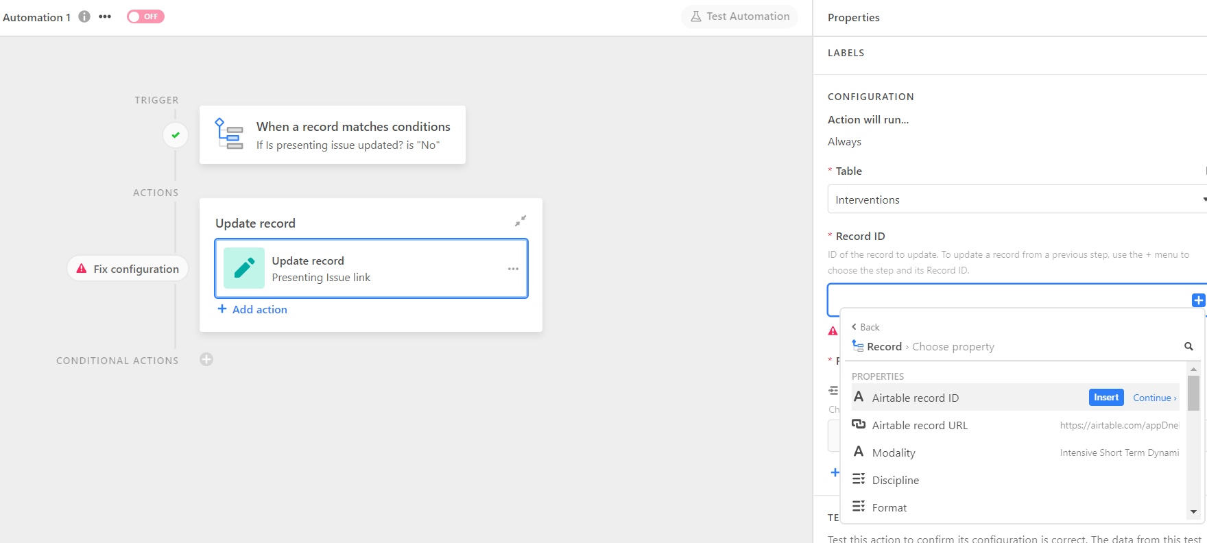

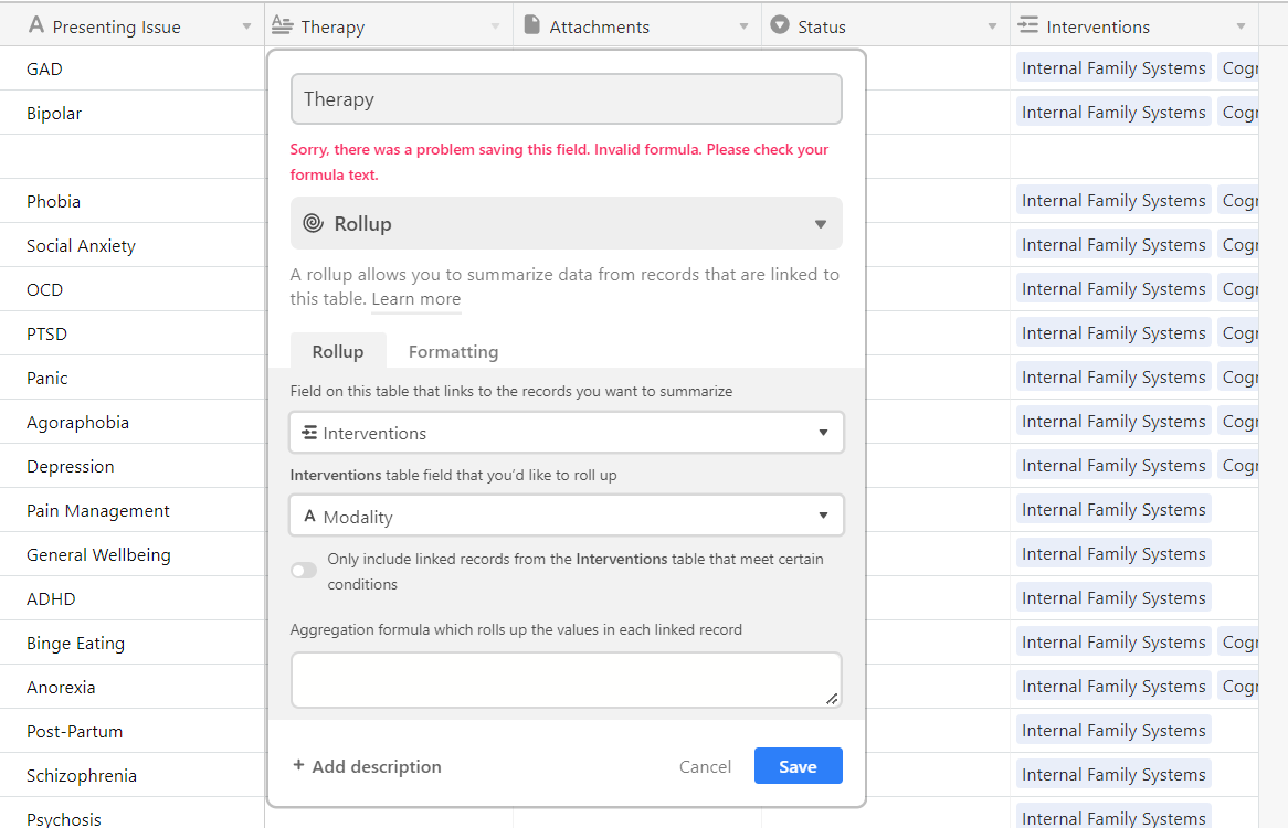

First time me doing this sort of thing. I’m getting an error when setting up a Rollup (as it looks like you did that in your screenshot for the Applicable Therapies field.
Do I need to do a Rollup?
Here’s my error
Cool that I have the interventions field and presenting issue field automatically filled out! Thanks for all your help!
Here’s my error
Ah, for the formula, try ARRAYUNIQUE(values)?

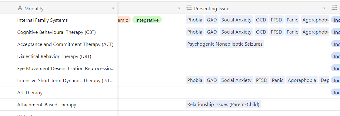

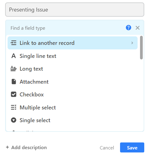

When I change the Presenting Issue field to a Link (rather than Multiple Select) I lose the colour formatting (where presenting issues were colour coded e.g. anxiety in blue; eating disorders in pink). Is there a way to maintain the colour coding?
Before:
After:
Hmm I’m lost with the Rollup and formulas (I don’t have a formula field to input the formula). Are they even necessary?
Before:
After:
That’s…an excellent point. I apologize, with this use case we can accomplish what we’re looking to do with a Lookup field and we do not require a Rollup or a Rollup formula at all. So sorry.
I’m afraid not, and I can see how important this functionality would be for your workflow. In this case, I would suggest having two fields: a multiple select field of Presenting Issues which are color coded, and a linked field to the Presenting Issues table. The linked field to the Presenting Issues table would basically always be hidden, and we would use an automation to keep the multiple select field and the linked field in sync

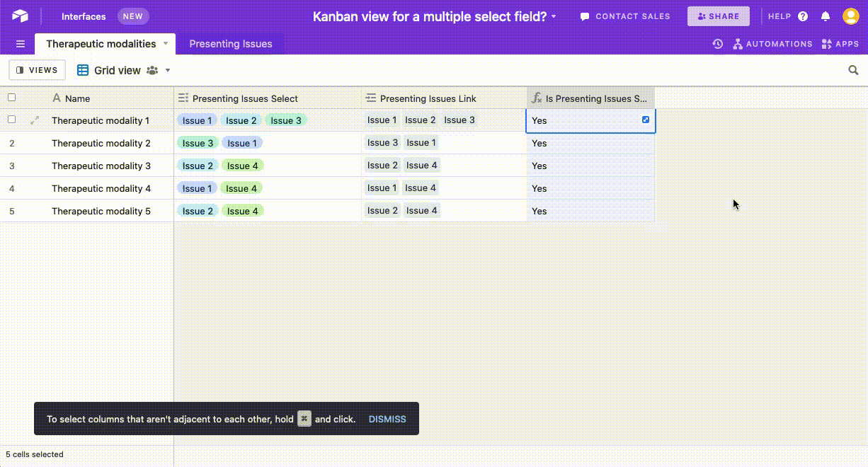

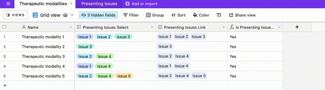

What formula are you using for the field titled Is Presenting Issue...? (or was that just to demonstrate that they automatically sync?)
Do you mean a Lookup field or Linked field?
Once I’ve matched all the presenting issues to the modalities I’d expect to only occasionally making adjustments. I assume I can manually force an automation where necessary.
The formula is:
  {Presenting Issues Link} = {Presenting Issues Select},
  "Yes",
  "No"
It’s used as the trigger for the automation; the formula field updates to “No” if the two fields do not match, and the automation will run once said formula field updates to “No”.

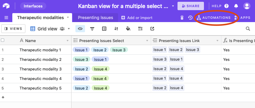

You can view the automations in the base by clicking the “Automation” button at the top right of the screen
And you can also view the formulas by duplicating the base!
(Apologies if you already knew how to view the automations / duplicate the base for formula viewing!)

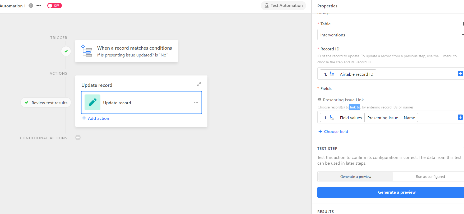

Am I correct in assuming I want to insert Airtable Record ID as the property?

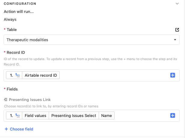

Here’s a screenshot of the automation:
You’ll need to change the table bit
  • May 18, 2022 3:10 PM UTC
Thanks - it works!
