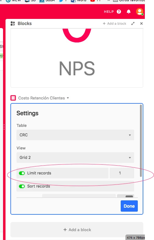

On the other hand, if you have the Pro version you can use Blocks. On the block named “Record List” you have an option to limit the records you want to show.
Hope it helps.
