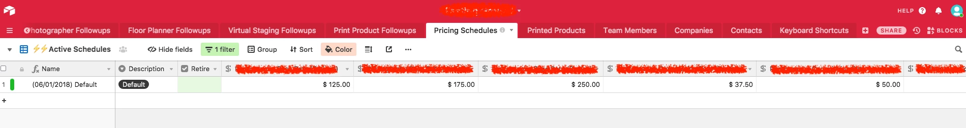

Here’s an example in a base I’ve built:

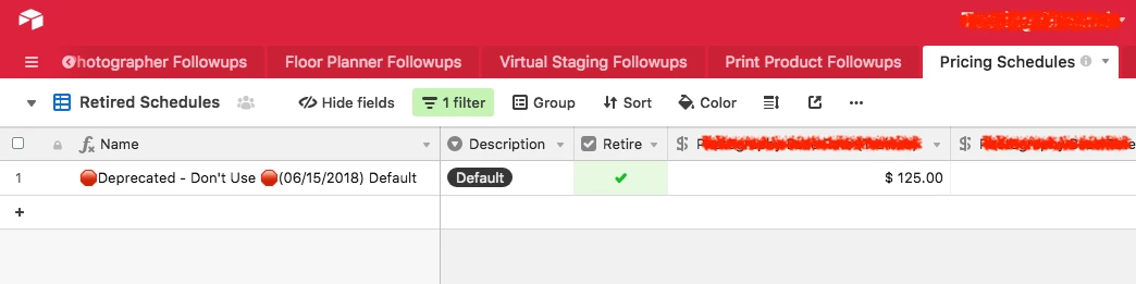

Retired schedules go here:
The formula in that name field is this:
  Retire=TRUE(),
  "🛑 Deprecated - Don't Use 🛑 "
DATETIME_FORMAT(
  CREATED_TIME(),
  'l'
  Description,
  " " & Description
