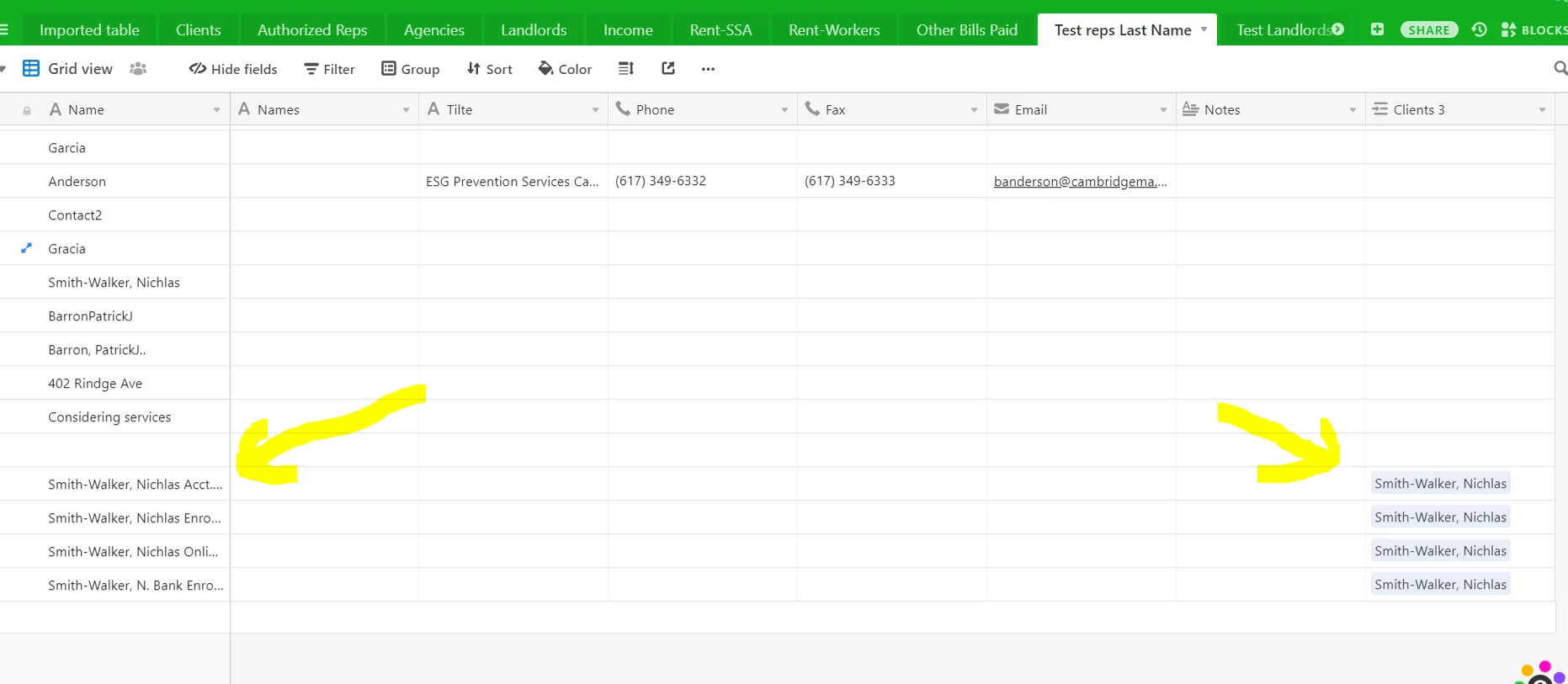

I’m new to airtable and responding to an older post. Here’s screen shots of linked field from Table A, then in Table B information from Table A field populates in Table B primary field AND creates a separate field.
Every time I try to link two fields this occurs??? Help?
Thanks, Pat
…Ugh as a new user I can only attach 1 photo :frowning: Here’s table B: with the info from Table A in the primary field and a created field also
Thanks, Pat

In the pictured link Table A had 4 attachments, Table B created a new row for each attachment (in the primary field and a separate field?
Also, If I’m linking a list of 10 names from a field in table A, why would there be any difference in the list of names when created in Table B, (which puts them in the primary field and creates a field)?
Thanks for your help. Sorry if I’m obtuse, I’m a newbie. Thanks, Pat

Thanks, but why is it adding the information from the field of table A to the bottom of the Primary field of Table B?
Thanks, Pat

What I’ve tried is only to take a field in Table A (mostly tried single text fields, but the picture shows an attachments field)
an example of what I’ve been doing is: I click “List of Names” Field (single text field) in Table A, link to Table B. Then table B adds the list of names from Table A at the bottom of the Primary filed as well as adds a field.
Thanks again for your help.
