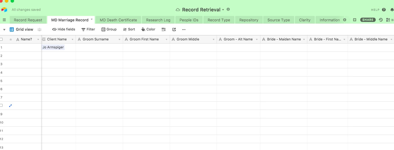

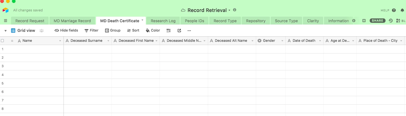

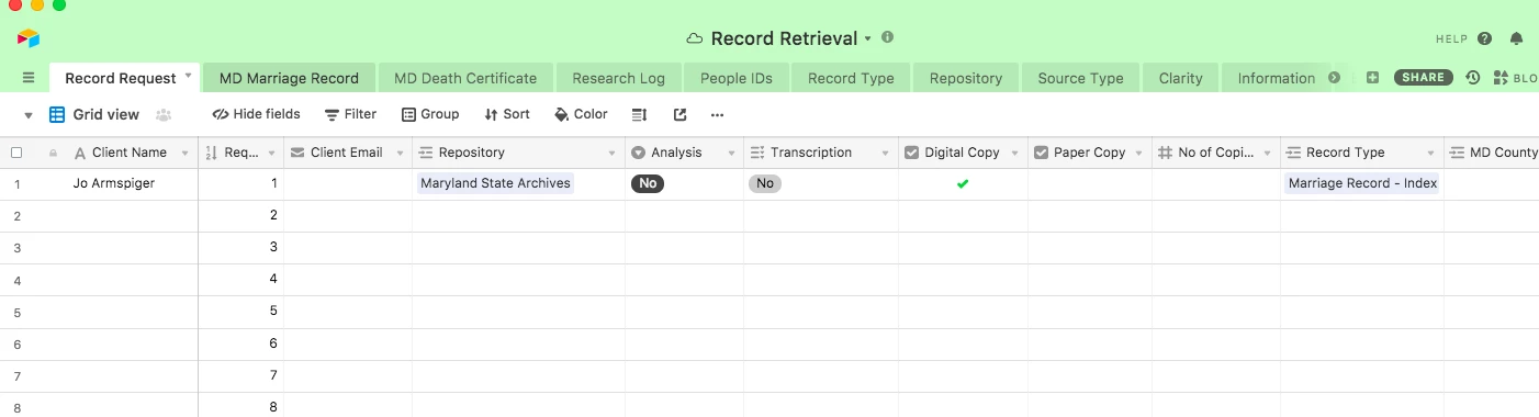

These are all the things that carry over, regardless of the request.
So I originally had all the fields in one table, but should they be separate and link?
These are the diff types of fields for each record
Marriage Certificate
then
Death Certificate

In case you are still trying to solve this, the way I would approach it is to have a client table, plus 20 reporting tables. The client table joins the marriage table with a unique client key, such as social security number. Likewise divorce table joins the client table, etc. You can find all records for this client by the unique key.
A way for the client to be able to select which form to use would be to build a static web page with a list of links for marriage, divorce, etc. These would link to the various Airtable forms that you made public.
I would start with a client table and 2 specific tables, to test it.
If on the other had, you need the client to enter some information into the database, then based on that info, build a custom list of forms that he is qualified to enter, I don’t know how to do that with Airtable!
