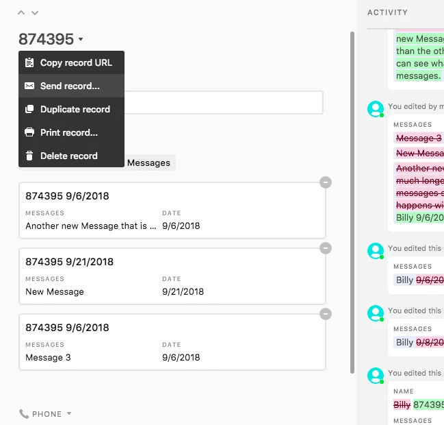

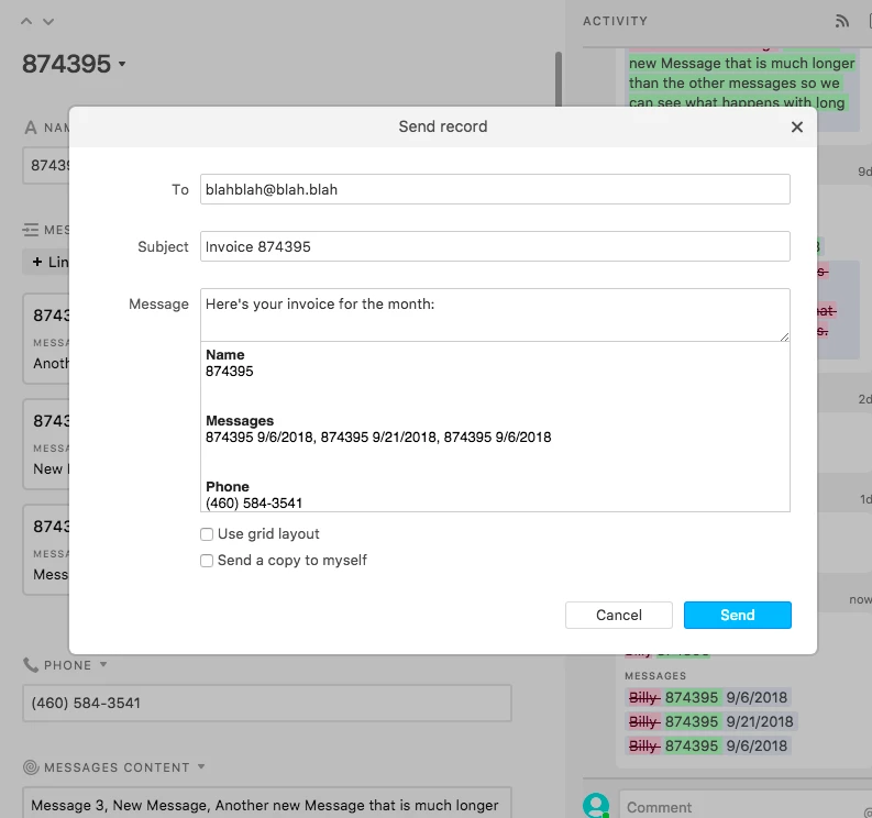

Lastly, if you are using the “Pro” plan (which I do recommend as a personal user myself), you can use the “Page Designer” block to fashion your invoices from the “Invoices” table. Another option, if you aren’t paying for the “Pro” plan, is to simply email the record with all the data you want your client to see, which can be accessed from the menu of an expanded record:
