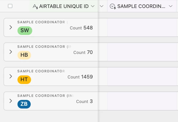

One field in the table (APPAREL) should look-up the value in another (SC APPAREL SYNC)

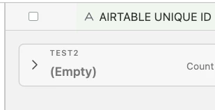

Here is the Field (TEST2) in the APPAREL table which should look up the SAMPLE COORDINATOR in the SC APPAREL SYNC
As you can see, every record in my SC Table has a value (no empties)
As you can see... all records are empty in the APPAREL
The field I am looking up is a synced field from another table. How can I fix this?
It's a little difficult to know for sure without seeing your base but it looks like you might be thinking of lookups differently than intended.
A lookup field requires the linked record field it's configured for to be populated in the same table that it is in. When this linked record field is populated, the lookup then pulls the value of a selected field in the linked table that is associated with the linked record.
For example, a lookup field in APPAREL will only populate if the linked record fields between APPAREL and SC APPAREL SYNC tables are also populated AND there is a value in the field you are looking up.
