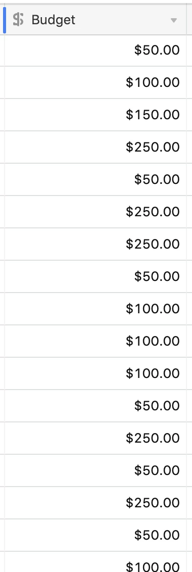

Here is the other table I am trying to filter in from, as you can see there is budget in every column (sorry for the narrow screenshot, private info cropped out)

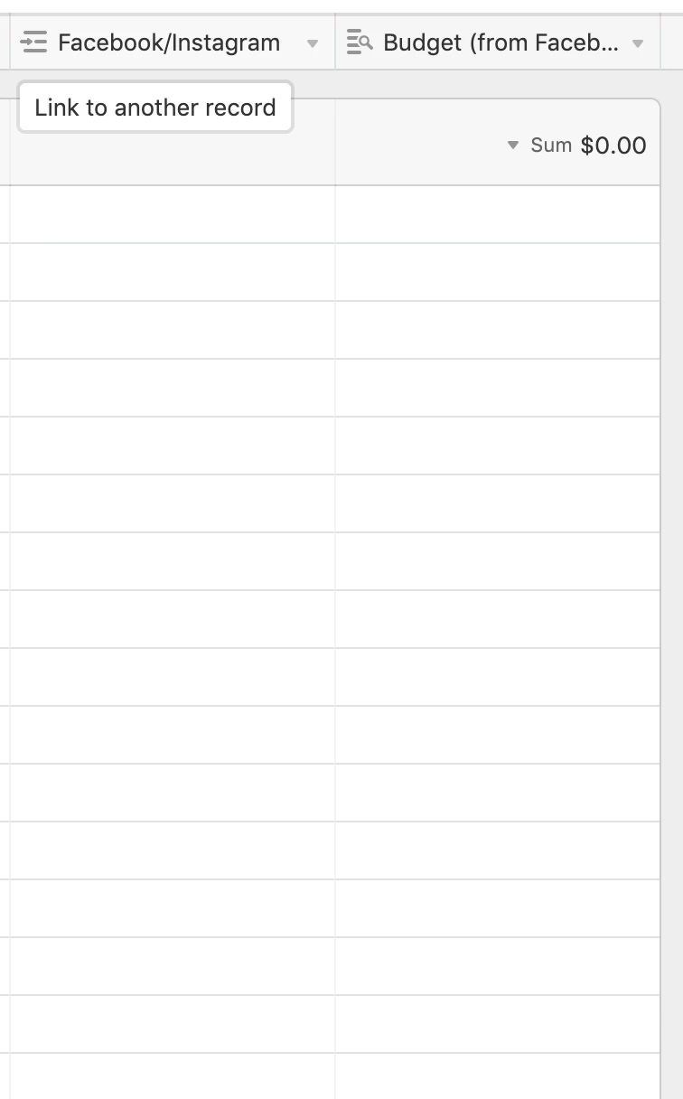

Hi @Kamille_Parks, thank you for the reply. Sorry, my linked record field was hidden. Here is the linked record field and the lookup field, but they are both filtering empty.

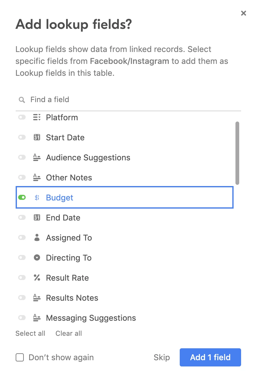

I’m trying to bring in the budget from Table B to this table shown above (Table A), so that the budget can be seen in both tables. Does that make sense? Here’s how I set it up:

A link to another record field doesn’t filter anything. You haven’t linked any records together so that field is empty. As I said in the other reply, if a link to another record field is empty then a lookup field has no data to display. Records don’t just link to each other automatically, you always have to tell Airtable what record needs to be linked to what.
I’d recommend reading Airtable’s support articles or watching a tutorial so you understand the basics of how Airtable works.
