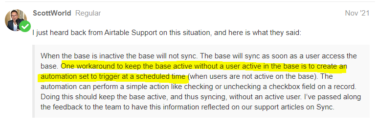

Thanks for your reply. I found this discussion of yours in another thread.
If I trigger such an automation from within MAKE…would that ‘wake up’ AT and keep the base active so the sync can happen? I ask because all of this will happen with users form submissions, which can happen at any time, so likely my own computer will be offline, hence my AT bases will be inactive on my end… how can I ensure the bases are active so the syncing does happen every 5 minutes (so I can use a 5 min sleep module in MAKE)? Thanks again

Oh right, that’s the other trick here. You can setup an automation in Make that keeps your base alive every 5 minutes. But you can’t actually time when Airtable is going to do the sync. It might be 5-10 minutes for the sync to happen. Maybe longer, I’m not sure. (If you’re fully dependent on the timing to be precise, you may want to setup your system in a different way.)

Not time specific, but at any time…
This is how I’m framing the MAKE scenario:
Form is submitted/received → records created in source AT base/table → activate/wake up AT → sleep for 5 mins (to ensure syncing) → Proceed with creating the linked fields in destination base/tables
No?
If fine, the key step here would be to know if I can automate the suggested simple task (ex, add/delete record) from within MAKE, instead of a scheduled AT automation every 5 mins… would that be enough to wake up AT so the syncing happens?

That sounds like it would work.
I would just do a search of your records… no need to add or delete records.
