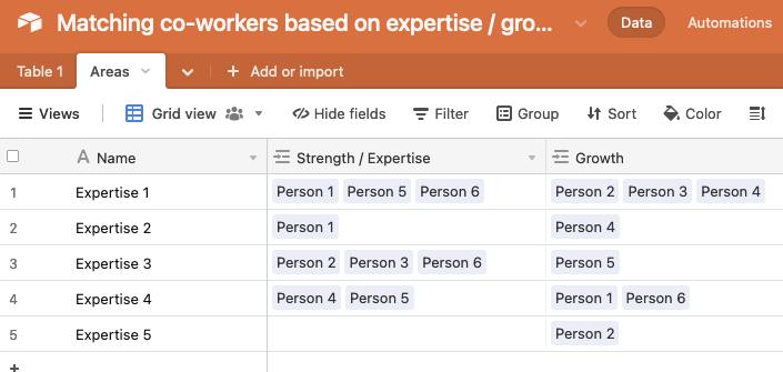

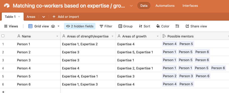

Hi Dante, I’ve put something together here that would be how I would handle it
(It assumes that the records are created via a Form submission, and that users are keying in the data in a comma separated list)
The idea is that, after users have submitted the form with the comma separated list of areas of strength and growth (e.g. Strengths = “Expertise 1, Expertise 2”, Growth = “Expertise 3”), we use an automation to paste those values into a linked field to a table called Areas, resulting in something that looks like this:
From here, you can tell that Expertise 1 is a strength for Person 1, Person 5 and Person 6, and that an area of growth for Person 2, Person 3, and Person 4

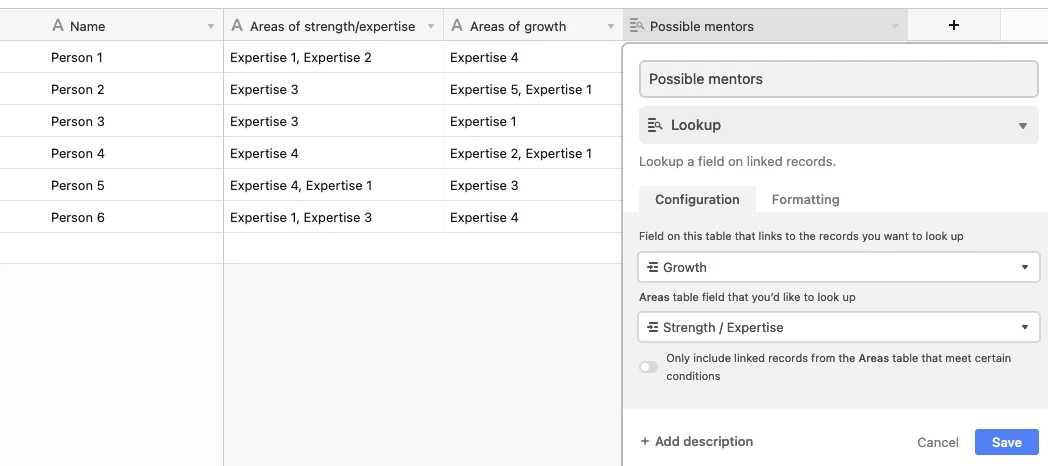

We then have a lookup field back in the original table that will list the people whose strengths match the areas of growth for that record
To view the setup (formulas, automations etc), you can duplicate the base by clicking the title of the base at the top of the screen, then the three horizontal dots on the right, and then the “Duplicate Base” button
Happy to answer any questions!
