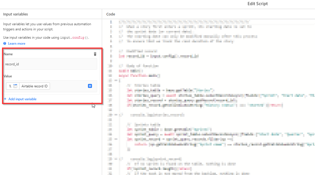

Automatic option
  • In the same automation that you have right now, create a new step
  • For that step you need to create an script to complete the task
  • If you are not familiar with coding, that can be a bit hard, but not too much
  • Check this thread, it may help https://community.airtable.com/t/delete-a-record-by-automation/39332/6
  • To make the script work, you must change “Table Name” for your actual table name
  • Also, you need to pass the recordId parameter to the script
  • To do so, when opening the script empty block you need to mimic what is displayed in the screenshot
If you can put all the pieces together, it will work. However there is always a bit of playing with them.

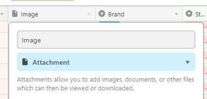

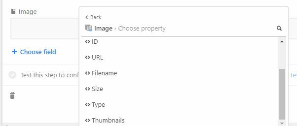

Thanks, I will take a look at the steps you mention.
I am using the attachments field type and want to take with it the images that are attached when moving it, but there are too many options to know which ones to take across.
(When I was initially creating the automation, I noticed that any fields set as picklist, I didnt need to select all the options - just the Name, for it to populate correctly, the ID and colour didnt need to be part of the automation)

Hi Karen,
Some fields types in Airtable can be treated differently, especially in automations. You have noticed that there are many properties that can be used for the copy (in this case)
That makes sense, and in the case of attachments, is specially relevant. You may need to copy the ID of the field, or the filename where you uploaded the file from, the size… so some of the properties or the contents of the field.
In your case, based on my test, you should use the URL. Just select it from the automation wizard and test it on your base.
Hope it works, good luck
