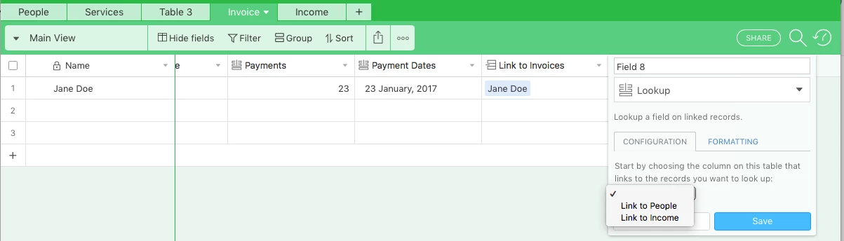

Here is an example self join linked field ( works fine ) then a field to do lookup on that join field. Note that the invoice table is not one of the optional selections. In this case I want to find the difference of the sum of all of the payments and invoices for a particular client, to arrive at an outstanding amount.
The best way I have found, so far, to solve this problem is to create a lookup field in the “income table” on the “invoice amount”, then create a lookup field in the “invoice table” on the Invoice lookup, in the “Income table”. Not great, or very elegant, but it works,
Any thoughts or suggestions are most welcome.
