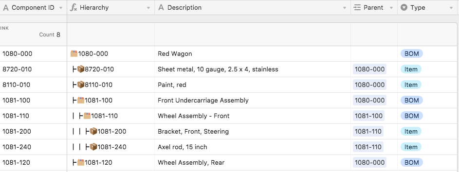

Will this work? It plays off of the “parent” concept I mentioned previously, which will mean an extra step as you’re setting up your hierarchy because you have to choose the parent by its ID. I didn’t put in every row from your example, but enough to ensure that the hierarchy symbols build correctly.
I wish it were possible to do all of this inside the primary field, but unfortunately that’s something that can’t be worked around due to all the field and table referencing going on (i.e. problems with circular references). However, if it’ll work, I’ll break down the steps for you.

The grouping UI wrappers take up a lot more screen space. If you’ve got groups within groups within groups, all that extra space adds up.
On top of that, groups work on individual fields. To nest groups, each grouping level has to operate on its own field, which means adding more fields to the table and trying to figure out the grouping order to make it all work.
And to cap it all off, groups don’t work on mobile (yet).
This structure gives you something that kinda-sorta behaves like groups, but without the UI-real-estate or field-count overhead, and it will still work on mobile devices.

To directly answer your final question, a component wouldn’t have two direct parents because it mimics the standard tree structure of the sample you posted originally, where any given item only has a single parent. However, to use the “Axel cap, red” item in that original diagram as an example, an item might be listed under more than one BOM (or assembly, to use the terminology of your second screenshot). That doesn’t mean it’s got two parents. It just means that some quantity of that item is needed in more than one assembly.

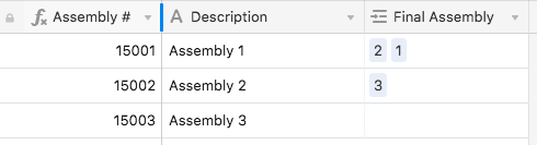

Here’s how these three tables might look. First the [Parts] table:
Then the [Assemblies] table, with the link field to the [Final Assembly] table visible. (This field was hidden in the [Parts] table, bit it’s also there.

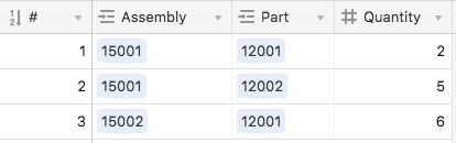

And finally the [Final Assembly] table, where you link to both of the other tables to indicate how many of each part is needed for a given assembly. (The first field is an Autonumber field for simplicity.)

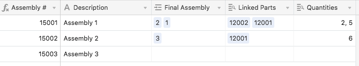

Back in the [Assemblies] table, the links from [Final Assembly] will let you look up all of the linked parts, collect their quantities, etc. for reporting.
Will this work for what you need?

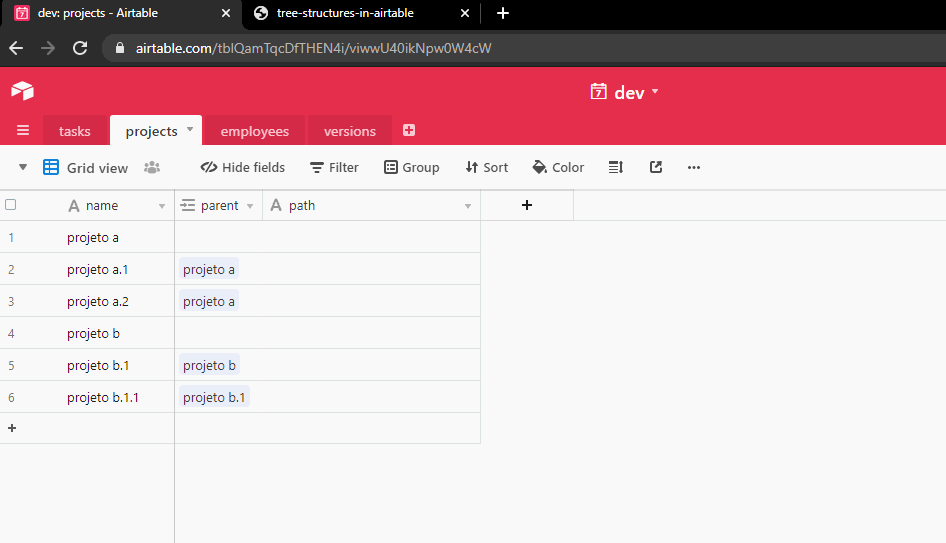

I had a similar problem trying to organize my projects and tasks in a multi-level structure. I’ve tried some solutions:
1 - You can have a table for each level all linked by a parent field and group items in each table by their parent. This is easy to set up but makes things somewhat unflexible. Maybe you will find yourself wanting more levels or different items will need different levels.
2 - Org Chart Block is a cool block but I think it is optimized to the situations it was created for. In my case of projects and tasks, I could not make it useful.
3 - Create a parent field pointing to the same table and update a path text field with all the ancestor structure like paths in computer file systems: “project a\project a.1\task a.1.1”. That is cool because filtering and ordering gain another level of usability. But I could only accomplish that through the Airtable API with a script.
The gif below illustrates that arrangement.
If you found that promising, I wrote a post detailing that API approach and also open-sourced and provided free access to a hobby app to do just that.
