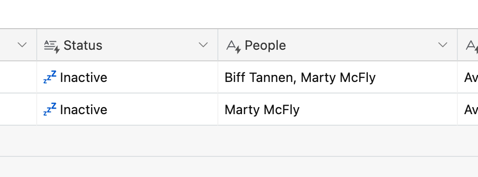

This kind of sounds similar to my issue, at least in regards to multi-sync and rollup fields.
I have a multi-sync happening where Base A's Table 1 & 2 are syncing to Base B's Table 3. I have a People table (Table 0 I guess) in Base A that is assigned/linked to Base A Tables 1 & 2. The People Table 0 info is being synced through to Base B Table 3 via Tables 1 & 2. There's also Base B Table 4 where the main work is being done that links to Table 3 records, and where I'm running into issues:

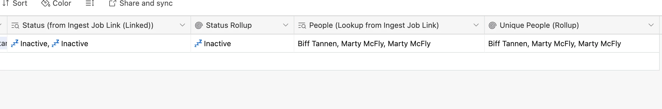

Issue: When trying to do a rollup for people to return only unique names, it does not work. Originally the names came into the target table (Table 3) with quotes since they were originally linked records, but even when I added lookup fields to Tables 1 & 2 and brought the lookup field info to Table 3, same behavior. What's strange is I was able to get unique values in another field (Status field) in the same tables. So I'm unsure why the behvaior is not consistent.
Table 3 (target table) below showing the fields. The "People" field is not a linked field type of course, due to the sync, and the "Status" field is no longer a formula field, but a long text field type... interesting:
Below, Table 4 when trying to get unique values. The record below has the two Table 3 records above linked
