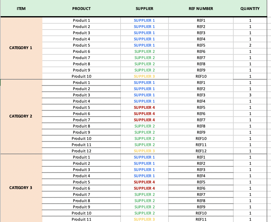

  • Apr 19, 2021 2:34 PM UTC
Hi there,
as promised, please find attached the excel file i was talking.
Every time we create a new project, we must pick from category 1,2,3,4 the products from different suppliers and then add the quantity for each product needed. Then, when we add the quantity it auto populates a new excel tab to get the quote.
Do you guys think this process could work on airtable AND if there is some interest to do it on airtable ? I’m not sure we could save time while doing it on airtable. Last thing, i’m not sure the best way to do it is doing so by using form OR directly with the airtable table.
thanks !

Hello @Alter345!
Thank you so much for the spreadsheet- it really helps visualize your process. The majority of workflow could easily be built in Airtable based on the info you provided above.
The primary way you’d be connecting information would be though linked record fields. You’d want to have a table for Categories, Products, Suppliers, and Product Orders (which would track quantity for each order).
The fields you’d want to connect are:
  1. Each Category to their different products
  2. Each Product to their different Supplier (which would have a field for each supplier’s reference). reference number)
Then when an order is placed you could you create an Airtable form with conditional inputs so that depending on what the user puts as their category you will populate the proper products and suppliers.
As to whether this workflow is best-—it really depends on your personal preference and workflow needs. I have personally found that more complicated your workflow is, the more Airtable shines with it’s complex views and automations functionality.

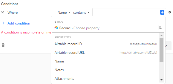

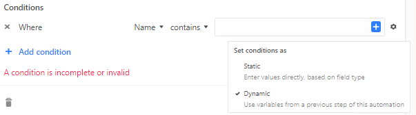

Forum|alt.badge.img+15
Oh I just found this Community post which offers another elegant workflow for linking your tables together based on conditional logic.
Morning Rose,
seems you guys rolled out “Dynamic Variables” to the automation “Find Records”. It enables you to set a condition as dynamic.
IF this were to be rolled out to the the linked record field type, you could accomplish this without workarounds.
This functionality would look through values in the destination table and filter the linked record options for only those records which match the conditions.
This Functionality is often requested.
Something to keep in mind for the devs. it would be great if this also applied to rollups and lookups.
