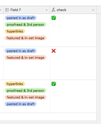

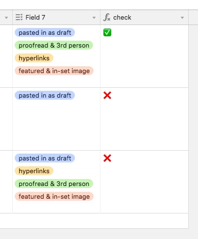

Ah, sorry - the issue there is the ordering, since, as you can see here using just the first four - it does work:
But I’m guessing you need to be able to add the options in any order. That’s a little more complicated - I’ll work on it.

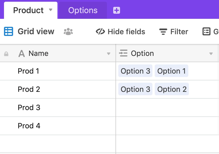

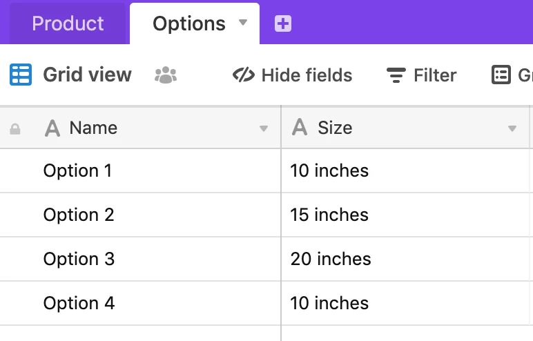

A better way to do this is to put your options into another table like this:
Then link to the options in the “products” table:

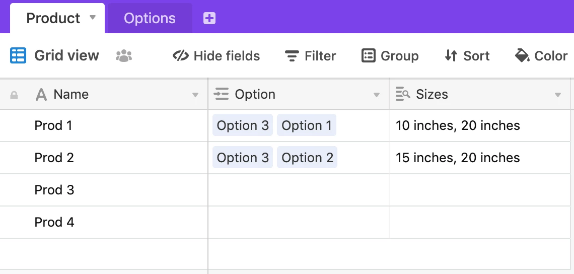

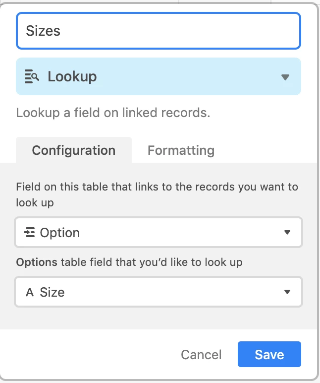

Finally, add a lookup field on the products table that references the size field of the options table:
Does that work for you?
