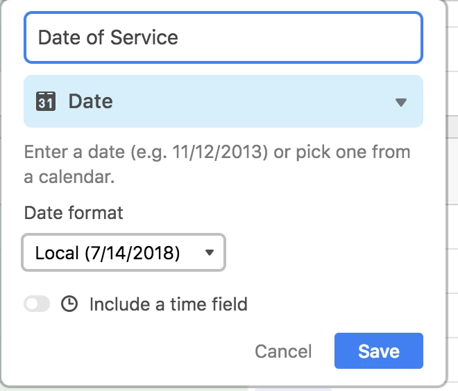

I am trying to create a name field with the name and the date:
{Client Name} & “-” & {Date of Service}
But it looks like this:
Jennifer Grube-2018-07-16T00:00:00.000Z
Why is it attaching the time part at the end? on the date of service field I have time turned off.

When you combine anything with a string, the result is a string. In this case, you’re concatenating an unformatted Unix date value to a string, so the resulting representation will be based on the ‘raw’ date field.
You have the right idea — to apply a format — but your execution is slightly off. The ‘formatting’ tab in a field configuration only applies to the visual presentation of the value when that field is displayed. As you discovered, it has no effect outside of this.
As @Elias_Gomez_Sainz and @Andre_Zijlstra suggested, what you want to do is use DATETIME_FORMAT() to convert the date value into a string representation in a specified format before concatenating it with the client name. In this case, the format you want is defined as 'M/D/YYYY'. (There are virtually limitless variations possible; see the full list of format specifiers here.) Accordingly, your modified formula would be
{Client Name}&'-'&DATETIME_FORMAT( {Date of Service},'M/D/YYYY')
