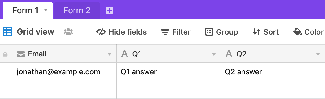

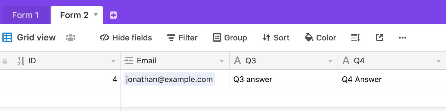

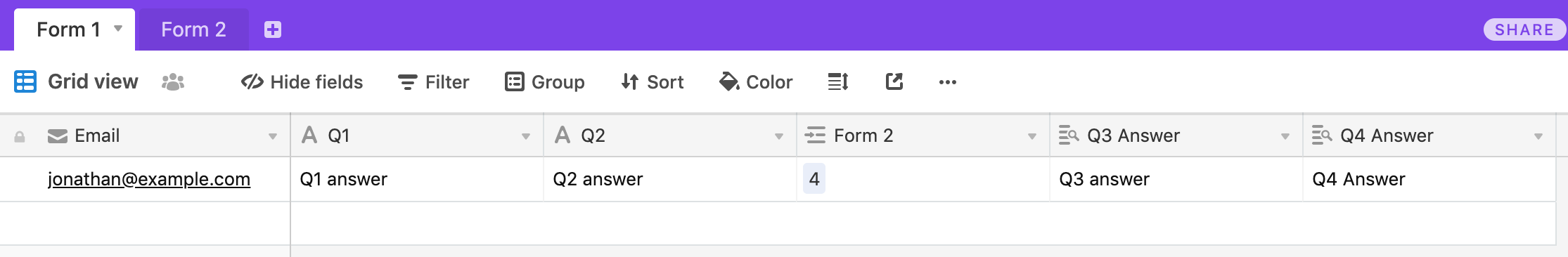

No - but you can link from one completed form to another (requires a paid AT plan), so you can get a multi-step process this way:
5 linked forms imply 5 AT tables, so the trick here is linking the different submissions to a single entity. This process is easier if you use a 3rd party form solution - Typeform or Jotform (with Zapier in the middle). Have a read of these posts covering similar topics:
