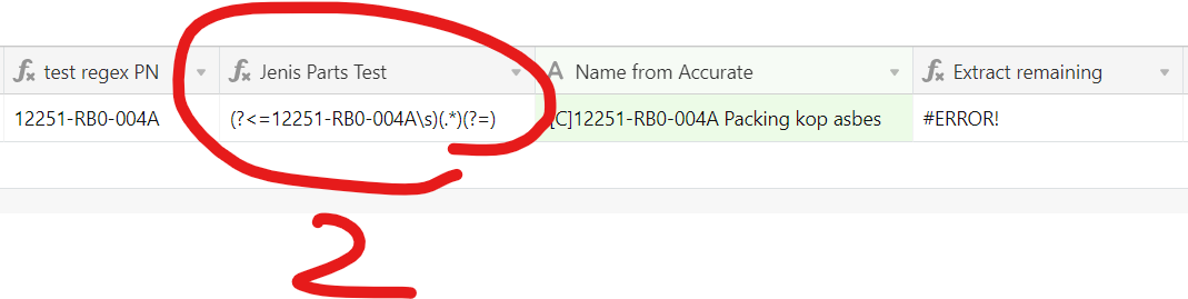

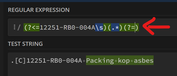

I have a regex that i tested with Regex101 and it worked.
Purpose of this regex is to extract the remaining words after “XXXXX-YYY-ZZZZ”
But in airtable i got #Error!
Number 1. Extracted a pattern
Number 2. I constructed regex exactly the same as that in Regex 101

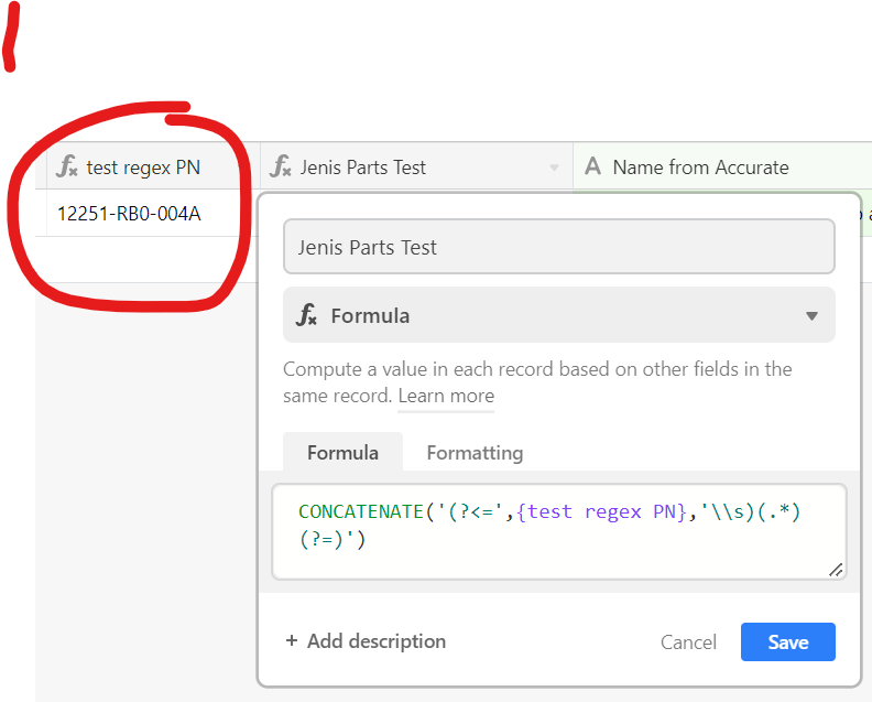

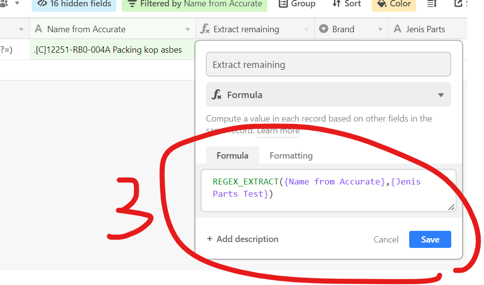

Number 3. I used this formula
What am i missing?
It looks like you’re using the wrong REGEX variant on Regex101.com, so you’re probably using some invalid tokens. The variant that Airtable uses is closest to the Golang option on the site. You can partly tell the difference by the prefix in the “Regular Expression” entry field.
I also think that you’re making the expression much more complex than it needs to be. Instead of looking for the part number specifically, notice how there’s a space after that part number right before the piece you want to extract. Forget everything before that first space and just pick it up everything after it. Try this:
TRIM(REGEX_EXTRACT({Name from Accurate}, " .*$"))
The $ token at the end tells the interpreter to focus the search at the end of the string, which lets us easily find a single space and everything after it, which should get you what you want. While the expression could be written to specifically ignore the space, it’s easy enough to just trim it after the fact.
