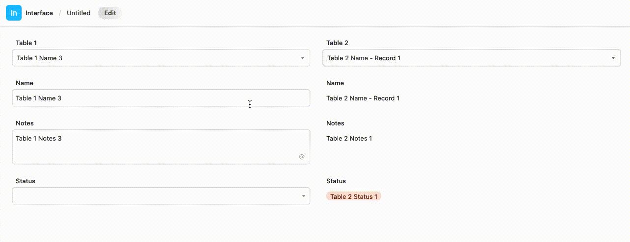

Hi Stephan, have you checked out the Interface functionality? It would allow you to edit records while also viewing records from another table at the same time. Check out this gif
It can be found here
