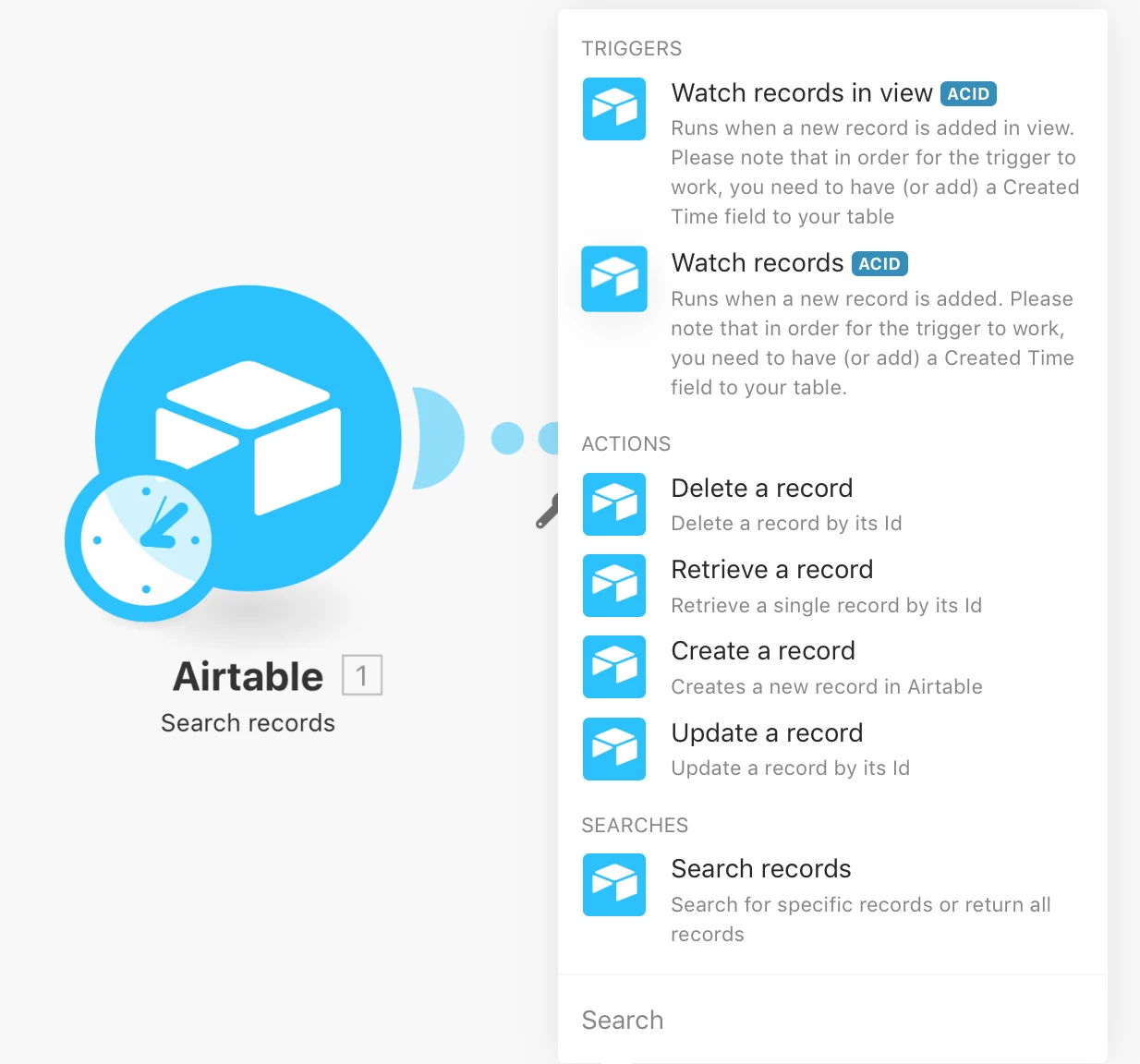

What’s baffling is that I’ve seen screenshots of Integromat where there’s an action for “Watch records in a view”, but it seems to have been removed somewhere

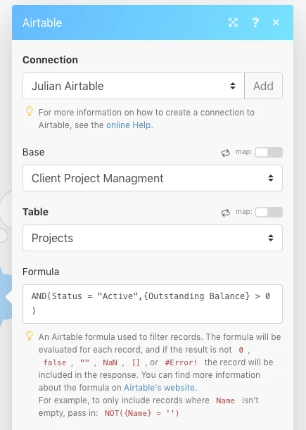

Hi
The key thing to remember is that the filters are AIRTABLE filters - so as you would write in formulae essentially - for example:
Which retrieves Active projects with an outstanding balance.
Your correct that the Watch records in a view option seems to have gone - but you can now watch records based on the modified date and also apply filters within the scenario. The big advantage is that is avoids you needing loads of views specially for Integromat which therefore simplifies the user interface for actually operating the base (and reduces errors if views are accidentally changed).
The other problem when using the old watch records in a view was that you often ended up needing views for different status changes and so on - and also, the scenario would only run once for a record when it first appears in a view. The latest changes make Integromat MUCH more useful with Airtable.

Hi
