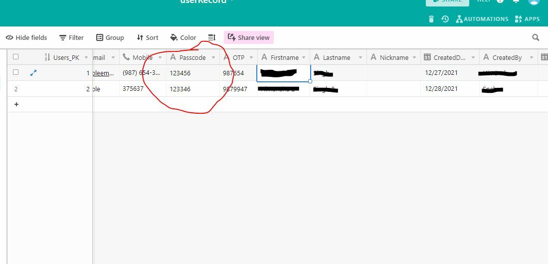

Hello,
I am new to API and node.js and I was trying to use filterbyformula for checking if an passcode (from airtable) matches with a local variable (inside the javascript file). But I am not understanding why I am getting value as undefined.
This is the table snip.

Just solved the issue the data type of the passcode was not string so that’s why the error was occurring.

Thank you for sharing the solution. However, in your screen capture, it does look like the passcode is a string. Was there more going on?
