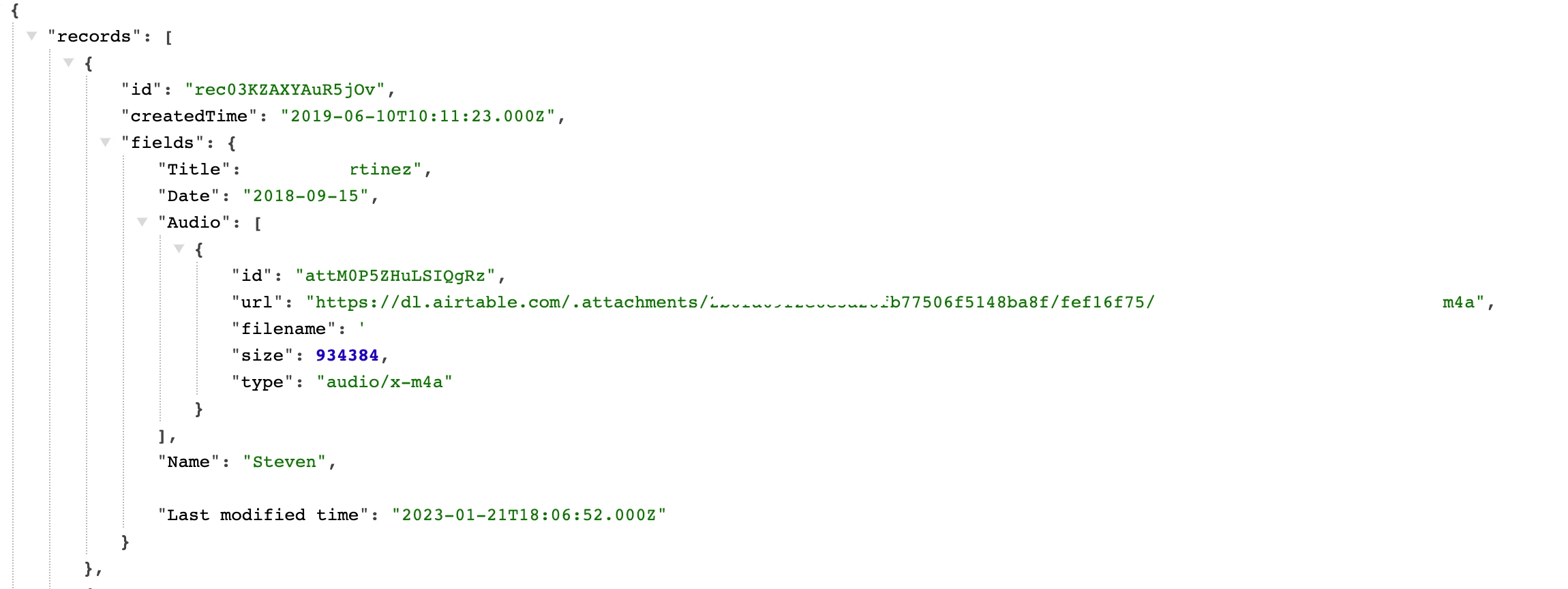

How are you trying to use the urls,
using airtable's API endpoint url, my API key to fetch data from my base to my wordpress site using wp_safe_remote_get().
and what actually is happening? Can you explain how you got the urls (csv export, copying a cell value, scripting, automation, etc.)? What is the format of the url, such as the domain name and whether or not there is a filename at the end.
I receive the data in .json format, which I pass through json_decod() in order to access the values in PHP.  I've included a screen shot of one record. you can see the url format there.
How do i know if i have a "viewer" url?

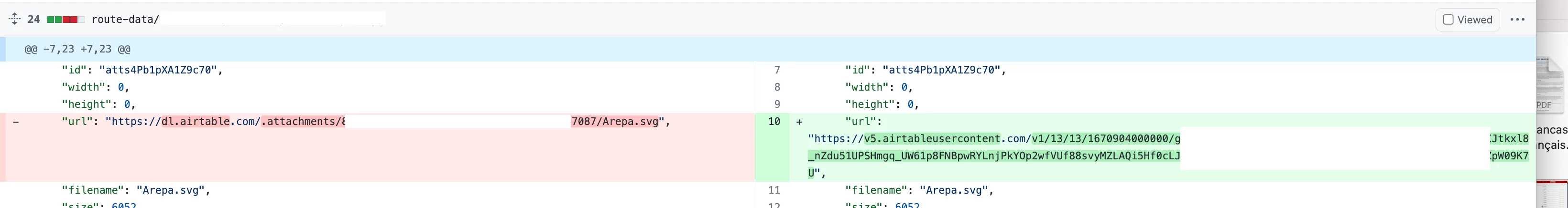

This format is the old non-expiring ones, when I "re-hit the API" they changed to this:
I was using the urls to point to an image (basically using airtable to host our websites images), with the new urls, I will have to download the images into my project to be served locally
