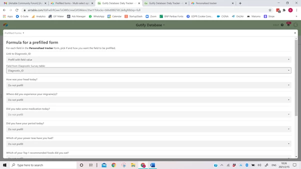

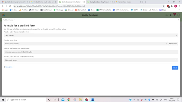

I am the developer for the “Prefilled Forms” app, and I have successfully used the app to prefill multiple select values. Usually when a prefill does not work properly it is because something about the the prefilled value does not match the field being prefilled.
Can you give more information on your use case?
  • screen shot of the configuration of your multi-select field in the table containing the form
  • screen shot of the configuration of the field containing the value used to prefill the form
  • screen shot of the formula produced by the script
  • screen shot of the record in the formula table containing the multiple values you want prefilled
  • screen shot of the prefilled form when you click on the formula results

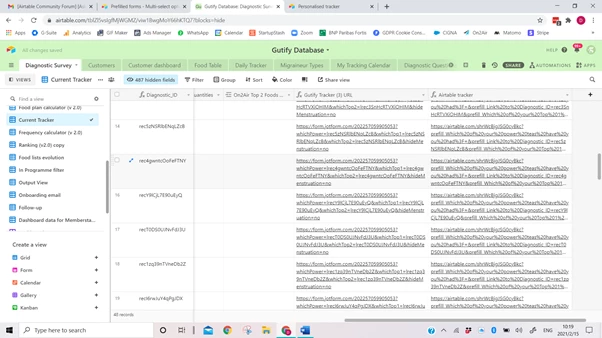

  • Feb 14, 2021 9:46 PM UTC
Dear Kuovonne,
Thank you so much for your reply! Much much appreciated.
Please find the screenshots attached.
Let me know if you need anything else.
Diane

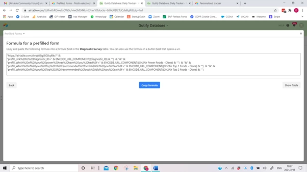

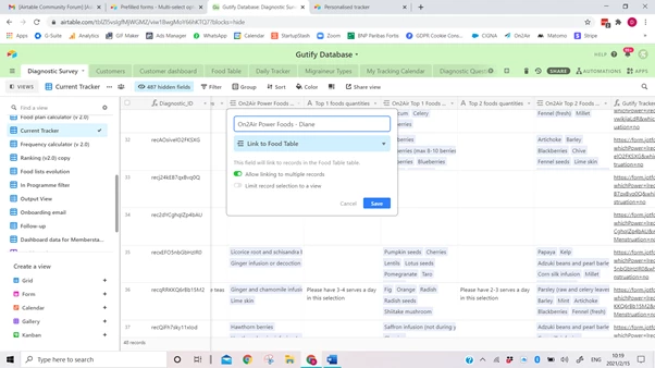

  • Feb 15, 2021 2:21 AM UTC
@Did
It looks like you are trying to prefill a linked record field (versus a multiple select field). It is possible to prefill both field types, but sometimes they need special handling.
Your screen captures are also a little blurry, so it is hard to see the exact values that you are trying to use.
Here are some suggestions:
  • Are you using the exact formula shown in your screen capture, or are you using a formula that you created a few months ago? I released a minor update to the app, and your screen capture shows that you have the update, but since you don’t show the configuration of the actual formula for the field, you might be using a formula created before the update.
  • Do any of the linked record values contain commas or quotes? Forms can have trouble prefilling linked records with commas and quotes.
  • Are all of the values in the primary field of the [Food] table unique? If there are any duplicates, the form will not be able to prefill values with duplicates.

  • Feb 16, 2021 11:57 PM UTC
If anyone was following this thread, the original poster scheduled an appointment with me for a zoom meeting and we found a solution.
Instead of directly using the linked record field, we used a rollup field with ARRAYJOIN(values,","). There also were some duplicate primary field values, and primary fields with commas.
