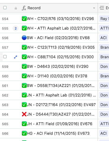

To manipulate this, I often use a formula in my primary fields that concatenates the most important info I need to see from that record when it is represented to me in another table’s linked record field. Thus, I end up with formulas like this:
IF({Next Eval Completed?}=TRUE(), "✅",IF(IS_AFTER({Next Due},TODAY()),"🔵","❌")) & " " & {Person Initials} & " - " & {Certification} & {ASTM} & IF(OR({AASHTO}=BLANK(),{ASTM}=BLANK()),"","|") & {AASHTO} & IF(OR({AASHTO}=BLANK(),{ADOT}=BLANK()),"","|") & IF(AND({AASHTO}=BLANK(),COUNTA({ASTM},{AASHTO},{ADOT})=2),"|","") & {ADOT} & " (" & DATETIME_FORMAT(Date,'L') & ") " & ID
That represent the primary field of my records like so:
Giving me a summary of important info about that record (status via emoji, initials of technician, test method abbreviation, date, and a unique ID).
