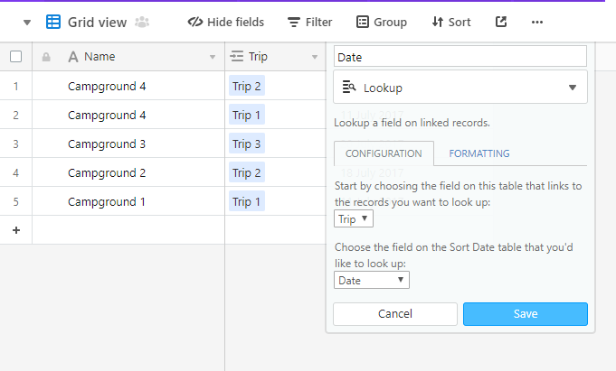

Tried it, but when I go to Lookup as the field type I am given the choice of which table and record, but not a specific field in the record. Am I just confused?
  • Jul 22, 2017 8:36 PM UTC
Whichever field in the campgrounds table that links back to the trips table is that one that you will use in the first dropdown of the Lookup field configuration.

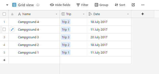

Here is my quick mockup of what I think your campgrounds tables looks like:
And here is the Lookup field configuration which uses the Trip field that links to the trips table which contains the Date field you are after.
