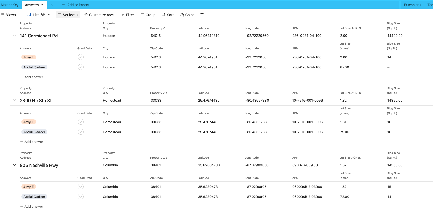

Yeah you could try using a List view with the data linked up.  Here's something I threw together with the answer key and two of the CSVs:
Link to base
To get the conditonal formatting thing you want you'd need to:
1. Add a lookup field per field in MASTER
2. Create a formula field that'd check each field's data against the lookup field data and make it output the % that's correct
3. Optional: Create a formula field that'd check each field's data against the lookup field data and make it output the fields that had different answers for easy review
And you'd set the coloring condition based on the % from the field from step 2
You'd need to dedicate some time to deal with the headers being different for each CSV too
This stuff is fairly straightforward so you shouldn't need to hire anyone I think!
