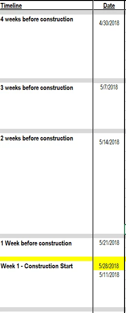

I haven’t really built anything out so I don’t have a lot to show you… But the photo above is a picture of my excel spreadsheet. Each date you see is linked to the highlighted “start date” and every time i change that one date, the rest of them automatically shift.
You need to put your “-3” in its own column, then hide it, and then reference it in your formula. E.g. The field could be called Days Prior to Start Date.
DATEADD(startdate, {Days Prior to Start Date}, 'days')
To add on to this, you would want to use a Formula to set the value of Days Prior to Start Date. Have it reference Timeline to determine its value.

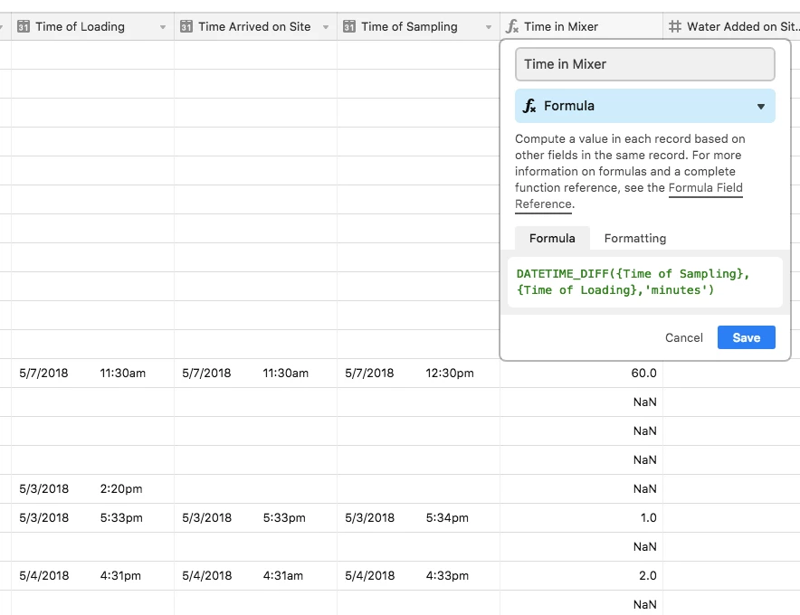

You define a formula at the header of a “Field” (what you are calling a ‘column’). That formula then applies in each “cell” in that “Field”(column).
Example:
I define the formula that applies to the “Time in Mixer” column - any new record I create will apply this formula, which looks at the “Time of Loading” date field and the “Time of Sampling” date field from the same record (ie, horizontally), and uses them to calculate a duration in the “Time in Mixer” field.
Does that help?
