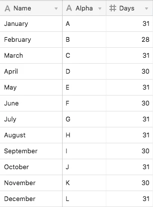

Next, make a new table; I’m calling mine [Monthly Habit Summary]. Set up the records and the first few fields like this:
Add a {Link2Calc} field in this table as well, with all records pointing to the same “.” record in the [Calc] table.

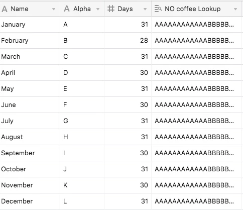

Next, add a lookup field named {NO coffee Lookup}, using the field that links to the [Calc] table, and pulling the {NO coffee Rollup} field from there. Now the table looks like this:

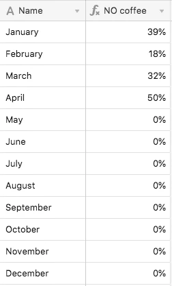

Finally, add a formula field with the same name as your original habit—in this case, {NO coffee}—using the following formula:
(LEN("" & {NO coffee Lookup})
- LEN(SUBSTITUTE("" & {NO coffee Lookup}, Alpha, "")))
/ Days * 100
In short, this counts the number of times that each month’s corresponding letter appears in the lookup, divides that by the total number of days in the month, then multiplies it by 100 to give you a percentage (change the formatting for the field to use the percentage option). Hide the unnecessary fields, and you now have something like this:
